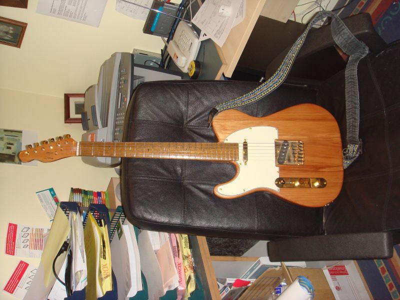

I havent quite sorted out the name for this, but THIS is one of MY favourite guitar shapes -
Number 4 has been a learning experience in many ways and as usual my excitement at seeing and hearing the finished guitar has got in the way of the inner perfectionist I am trying to encourage. I think he was somewhere else for this one.

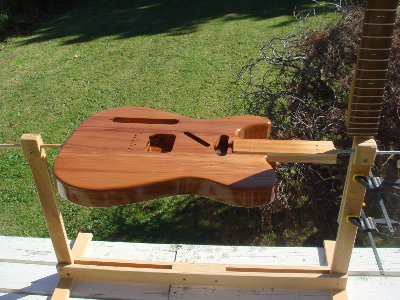

Here it is on the rotisserie spray jig curing in the Auckland winter sunshine
The finished article
A closer up

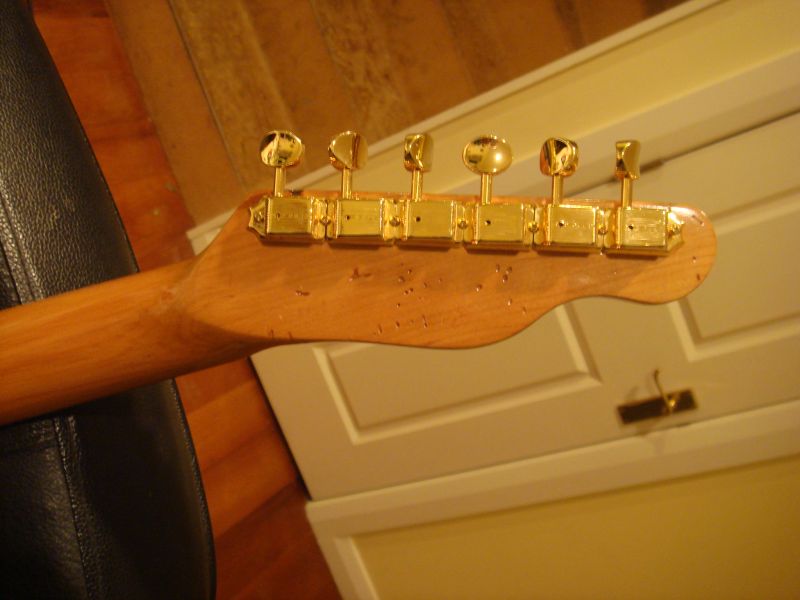

Headstock back - complete with borer habitat!
I see all the things I got wrong, but it feels and sounds pretty good. Perhaps the most humurous mistake was deciding I really wanted a zero fret then forgetting to extend the neck by the same amount. End result was that I couldnt get the intonation right until I refitted it a bit farther forwards. Or possibly the over the top fretboard radius - the telecaster that thinks its a violin.
This was meant to be a recycled guitar - the body is heart rimu from the end of a bed I made about 30 years ago, the neck is a bit of recycled matai I found in a timber yard - complete with borer holes - (if he's still in there, then at least he's deaf now!!). The fretboard is a piece of greenheart decking timber I had stuck under the house. I read somewhere that greenheart is pretty hard so I thought I'd give it a try. The running gear is all new of course but it really annoys me that I cannot get gold plated left handed bits, hence the bridge pick up is the wrong way round.
I still need to sort out the buzzing - lots of helpful advice on the tdpri forum - but its got that TWANG and I can't put it down long enough to get that done.

Great looking build! I'm actually about to start spraying a Tele and was looking at different ways to do it. For bolt on guitars, this Jig is a cracker!

The rimu was OK, although I didnt have to do too much to it, I put the bits through the thicknesser then just had to sand it to get it nice and level. The routing wents OK, it tends to burn if you go too slow or try to do too much, so it was a matter of many passes make light work.

Hi Lillian - thanks for the comments - yes it feels like its been around for ages but its only been a few weeks, - love at first pluck. The finish is one spray can of Dulux nitro enamel! NZ$10!! I suppose I should have done a few more coats but... I didnt.
I'll have to go into my shed and give myself 25 lashes with a bit a scrap tonewood some other time for being so impatient. I'm never going to make into the Luthier Hall of Fame at this rate. :cry:
