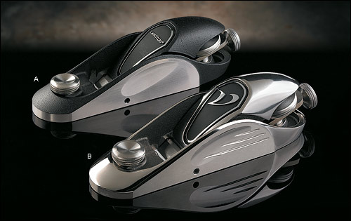

Post by Dominic » Mon Jul 06, 2009 9:59 am
I got one of these for Xmas. The shiny one at the bottom, the Veritas NX60. Beautiful tool. Use it all the time. The apron plane would be nice as well for a smaller block plane.
I've started making arch top guitars now so I also need to consider a tools usefulness in that area.
Post by Kim » Mon Jul 06, 2009 12:17 pm
Oooooowwwwaaahhh, I got the awn Dom 8)
Post by Nick » Mon Jul 06, 2009 12:39 pm
mmmmmmmmmmmmmm melted cheese....
Gawwwwgeous, shiny toys.

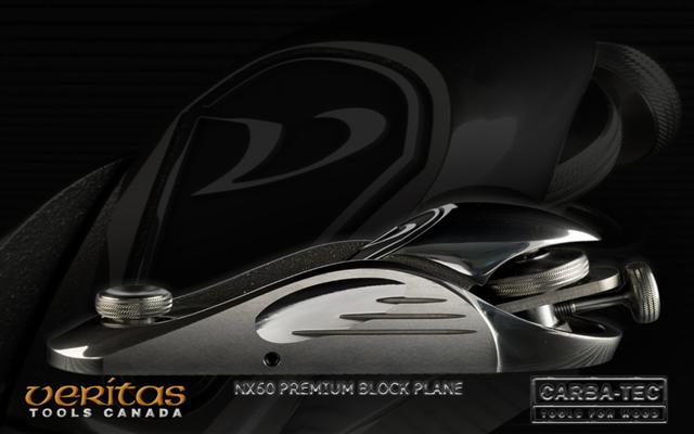

Post by Clancy » Mon Jul 06, 2009 4:16 pm
Thanks for that Dom....all I get to do is look at the computer wallpaper & you get to use the real thing!
Kinda like being 16 & one of your mates was going out with the hot chick & all you had was....well....pictures. :oops:

Post by Clancy » Mon Jul 06, 2009 6:53 pm
Sorry Martin - great planes, YES!
But do they look like they've just roared down the hill to Monte Carlo with a european super model in tow to blow a small fortune on blackjack.
Sadly - no...
Mate, these planes come dressed in their Tuxedo :wink:
