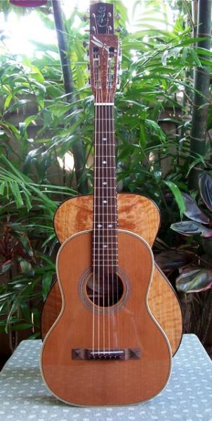

Allen, do you have a pic of your 'size 5' guitar.
I checked your website but couldn't see it there.
Sounds like something I'd be interested having a go at making.
Post by Allen » Mon Jul 06, 2009 5:22 pm
Here's a picture showing it in front of a 000 to give you an idea of scale.
I've got more pictures if you want. My avatar is the headstock on this guitar.

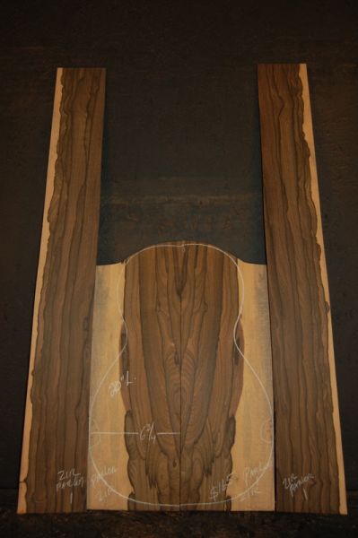

Post by Allen » Mon Jul 06, 2009 5:31 pm
And this just showed up in the post today. Guess what it's going to be?

Post by liam_fnq » Mon Jul 06, 2009 5:52 pm
its gonna be unreal by the looks of things.

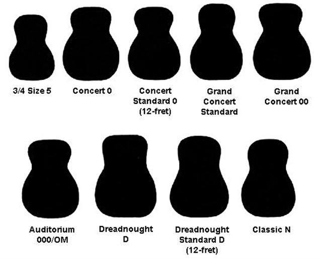

Post by Clancy » Tue Jul 07, 2009 11:49 am
Thanks for the pic Allen - definately on my list now.
I always got confused what shape was what.
Found this chart somewhere along the way...( & then forgot I had it)
