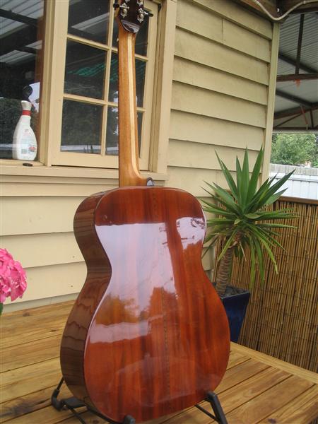

Post by Bob Connor » Sat Jul 04, 2009 5:24 pm
You wouldn't know the difference between it and real Honduras Mahogany.
Both body and neck are from Fijian Swietinia the body is stained because that's what the customer wanted.

It's certainly not a dark reverby sounding wood like, say Indian Rosewood or Cocobolo. Much dryer response.
It's a bit hard to describe in words because everyone hears something different.
This guitar is quite bright but that's probably got more to do with the top than the back and sides.

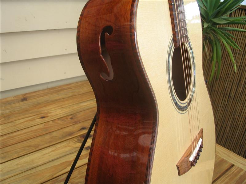

Post by matthew » Sat Jul 04, 2009 10:28 pm
hey guys
this
was made from Tas Oak and WRcedar from Mitre Ten in Sydney.
sounds fantastic.
You just have to choose carefully.

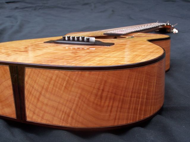

Is this the type of Cypress (Cupressus Macrocarpa) that you're talking about?
