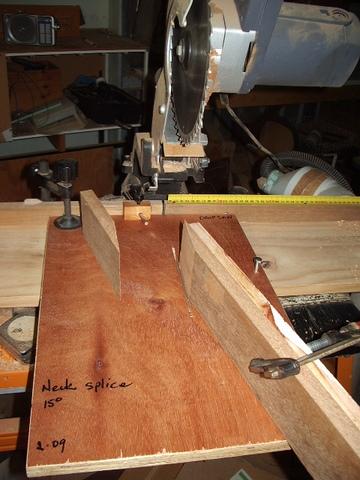

Basically I wanted to see if there were an super simple wizz-bang method out there. For some reason this step and the actual carving of the neck itself are freaking me out. I had no troubles hand planing the top, back and sides to thickness, bending the sides, or making the rosette (although I'm not 100% happy with it, and may end up re-doing it a third time). In all probability I'll do fine with this as well. I guess that with a young family, work and part time uni getting the time to get out and actually build is difficult to say the least. Consequently, I absolutely loathe stuffing up something and having to waste time (and precious tone wood. No Martin-esque drool-worthy wood stash here!) to do it again.
I'm reluctant to build more jigs. I've spent more time making jigs than the guitar, and I've run out of room to store the things. Besides I don't think my tiny three wheel hobby bandsaw could accomodate the width of a neck blank. It's good for roughing out brace blanks though.

Joel, I understand your frustration. It seems that in the beginning all we do for the first guitar is build jigs. At one point I was ready to give up because I was tried of making nothing but jigs. I didn't have the money to buy what I needed or thought I needed to go to the next step in building, heck to even begin building. I almost quit before I began.
You have three choices in building your neck.
1) buy one/ have one made for you
2) cut it out with a hand saw and clean it up with a plane
3) cut it with a hand saw and clean it up with a router
The router is a simple, quick, sort of, way to clean up the scarf joint. But it does mean another jig. The jig is easy to put together from scraps and if you use inserts, it can be disassembled for flat storage. http://www.buildyourguitar.com/resource ... arfjnt.htm You might have to go back to the resource page, then to tips. It doesn't seem to want to load for me.
