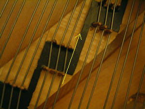

B.T.W. these spruce soundboards are around 3/8 " ( 9.5 mm.) thick which probably seem a little oversize to most of us , but as a piano has around 240 strings , the stress from end to end is about twenty tons . Although the string down bearing angle on the bridges is only slight ( measured with feeler guages ) , it still equates to roughly 6 ton . You would have noticed the string passes between two off set bridge pins. This provides positive downbearing and lessons the need for such a dramatic break angle.
I had thought about puting this same idea to guitars many years ago only to find Steve Grimes had patented the idea in the 90's . From what I remember , Gibson bought the patent , but to my knowledge , have yet to utilize it. Grimes still has the right to use it for a set number of instruments per year. The advantage of this system is that you could build a flat top guitar with a tailpiece arrangement and disregard the lack of downbearing a flat top offers.A number of attempts have been made by luthiers to emulate the design without encroaching the patent. Incidently ,piano bridges are usually made of Maple , although I have seen other variations of a maple capping over end grain.This ,supposedly to transmit more excitement to the soundboard. The 'black' on top is a graphite mixture ,painted on and buffed to aid the string's movement through the pins
