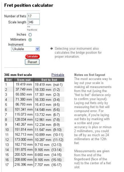

I need advice on how to continue the frets past fret 12 on a soprano uke? this is so I can continue the fret board all the way to the sound hole.
Currently I have been stopping at fret twelve and making the fret board fall short.
Is it as simple as adding in the amount of frets i require and then recalculating the scale on the scale calculator?
http://holeshotnitro.com/

Post by hilo_kawika » Mon Jun 22, 2009 12:35 pm
yes.
aloha,

Post by Hippety Hop » Mon Jun 22, 2009 12:39 pm
Stewart - MacDonald's fret calculator

Post by obmit » Mon Jun 22, 2009 12:55 pm
hilo_kawika wrote:yes.
aloha,
Dave Hurd
Hippety Hop wrote:Stewart - MacDonald's fret calculator
Thanks guys
Thats the calculator I used and just played around with the number of frets and now i understand.
Tim

Post by obmit » Mon Jun 22, 2009 12:59 pm
At this length the join in the rosette (yes I'm finally doing one) :shock: will be covered.

Post by Hippety Hop » Mon Jun 22, 2009 10:07 pm
That's the way Tim. You'll note their "non-compensated bridge position" shows 348mm for a 346mm scale length.
So far I haven't experimented with the bridge position. Just stuck them at 348mm on trust, but I'll admit I'm not completely happy with their intonation.
