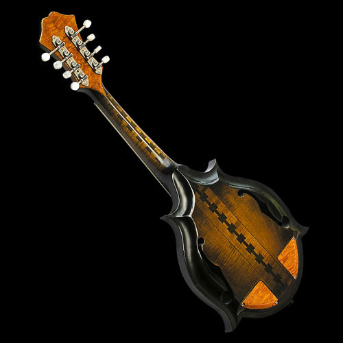

How about battery compartments in solid bodies? Also electronics cavity covers - though careful planning is required to avoid any interference with magnetically sensitive components. I've done this before on a solid body mando I made. I initially used screws but changed it over, seemingly with no adverse effect. Shown below is the instrument pre-mod. One cavity is the electronics the other was simply a matching cavity that I velvet lined for picks or whatnot. I'm looking at magnetic covers on two of my current full size solid bodies too. Any comments or concerns anyone? Stu??

Jeremy, I was afraid to put rare earth magnets in my access cover, thinking they would probably have some negative effect on the electronics - but that needs a real-world test to prove if those little hyper-magnets actually do cause any problems. If the cover is flush with the guitar, then the other thing is a way to get the cover off - a spot to slip a fingertip under, or a tiny handle of some sort?

Wish you hadn't mentioned the finish - nor looked too closely :oops: it was my first attempt at a hand rubbed burst and a different lacquer product. I wasn't too happy with the results or overall finish to be honest. In hindsight, I think I would have preferred this to be left a 'natural blonde'. Oh well... Things we do. That was six or more years ago too. Thanks for your comments nonetheless!
Dennis,
This was my initial concern as well. However after trying it on the mando, I don't believe it will cause much issue. Having said that, I am no electronics expert which is why I threw the question out on the forum in the first place. Although those little magnets are powerful, I don't believe they throw a large enough magnetic field to adversely effect the electronics if planned carefully.
Also, yes, I would create a 'notch' for a fingernail or pick to lift the cover. Personally I would not go for a 'handle' look as for me the idea here is clean aesthetics as well as practicality with respect to access.
