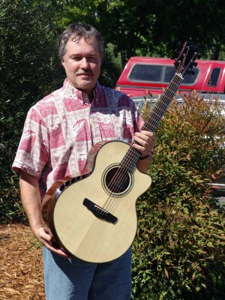

This what you're looking for?

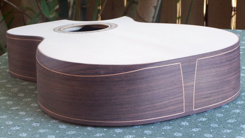

0M with armrest
It's a hell of a lot of extra work, as you'd expect, and pretty daunting to contemplate on starting, but I was surprised at how easy it actually turned out to be. Perhaps first time lucky though.

Post by Allen » Tue Jun 09, 2009 5:31 pm
Here's about the only pictures that I have that might help out.

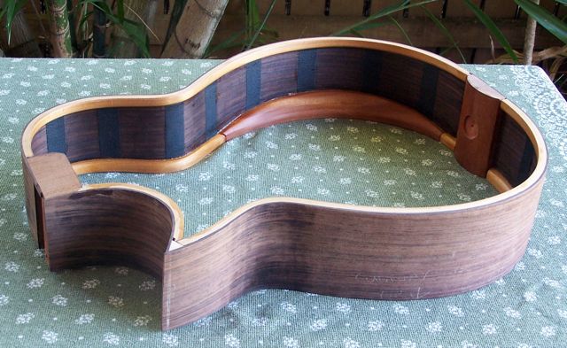

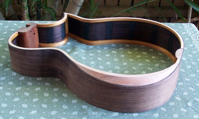

The bevel area that is scooped out of the side was done just as in Matt's tutorial, then the lining area for the bevel is installed. This shows it after it's been shaped and the hours and hours of work to get it to this point are just a faded memory. You will have a step from the sides to the bevel lining the thickness of your sides.
And how it looks inside. This was made up of laminated bits of mahogany. That way I could minimize the amount of short grain when wrapping around the lower bout.

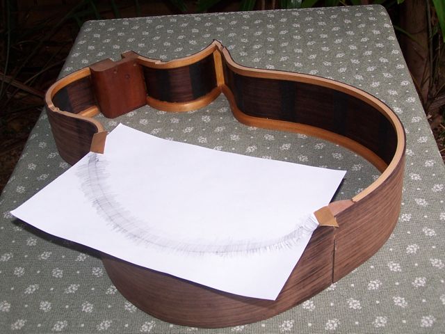

I took a rubbing of the shape of the bevel, and carefully cut it out. When the top was aligned to the body, I penciled in the edge of the inside of the linings, marking where the bevel started and stopped, Then laid out the bevel template on this line to give me an idea where I wanted to trim the top so I ended up with just the right amount inset for my purflings.
This shot shows the little "Stop Block" on the right hand side. I tacked it there with a dab of hide glue after locating the top in the correct location. That block, along with a small bamboo skewer used as a locating pin through the top and into the neck block (hidden by the fret board) are what holds everything in alignment during glue up. Remove stop block after top is attached.
As for getting purflings and bindings installed, it's a long process. For myself, I felt that there were far to many things to go wrong to try and tackle all of this in one go, so I did it a little at a time. The back can be done as usual, as well as the opposite side of the bevel on the top. However on the bevel side, I installed the purflings around the edge, next to the top by themselves. No bindings. I also installed the purflings on the body side of the bevel, letting them run just a little long.
Now the really tricky part comes, as if you didn't think that up to now was difficult. I took another rubbing of the bevel area using some 2" wide masking tape. I cut the profile out, and taped this to my veneer. This I had previously bent on the iron to an approximate curve to match the bevel. Being a compound curve, it was rather tricky, and lots of back and forth trying to get it close.
Now cut out close to the template, and then I used files, sanding drum etc to keep refining the shape until it fit perfectly. Remember that the edge that you are shaping isn't going to be at 90 degrees, it's going to be a compound angle that is going to try your patience beyond anything that you've attempted before.
Once right, glue it in. I used lots of brown binding tape and epoxy, as I couldn't be 100% sure that I had good wood to wood contact through the entire bevel. Once dry then I used files and chisels to clean up the ends where the bindings would run smoothly into the bevel. And then finally installed the remaining purflings on the body side (ones next to top were installed as one piece previous to bevel veneer) and the bindings. The bindings run just a little long over the bevel. Once dry, sand or file bindings that over hang the bevel into a smooth, seamless transition.
And this is what I ended up with.
Good luck with it. Nothing like diving in and having to make it work.

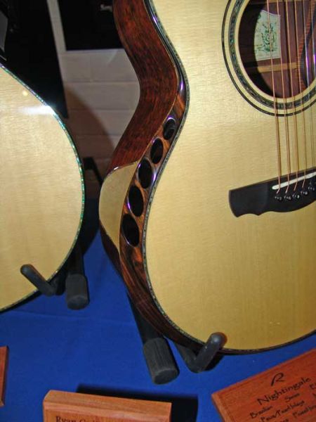

Here is a pic or two that I took of Kevin Ryan's bevel and flutes from HGF 2007:
Post by Allen » Tue Jun 16, 2009 5:50 pm
Kevin's work is inspirational. I had several images from his web site that I used as my desktop wallpaper for many months while I was contemplating the building process on this guitar.
