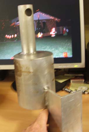

Hi guys now the problem I'm having is in bending Makore (Brazillian cherry, I thicknessed it to 85 thou (2.2mm) as I've done previously for rosewood and mahogany, they both bent easily, the rosewood was so so easy, this is a real pain, I've got one side done, and it really needed soaking and keeping it nearly saturated all the time to make it move, and now the second side is still putting up a fight I usually bend over a 2" stainless hot pipe.
Also I recently struggled bending maple binding for a uke, until I soaked it overnight and just persuaded it into the channels then taped it left it overnight and just touched up the spring back on the iron.
Any clues or tips should I build a fox bender I have the bulb fittings to hand, and some 22 swg mild steel I know I'd need to straighten it after use though.
Bending Problems
I do find the Fox style bender to be so much better at getting sides bent without drama. Your dimensions seem about right, so it might just be that this wood is particularly tough to bend. Maple has always bent very easy for me, and bindings shouldn't take anything special to get them to move. Don't know what the issue could be there.
My first bender used the light bulbs and while it worked, it was a much slower process than with a heating blanket. One thing to keep in mind with the light bulb method, is to have enough metal slats in the form to act as a sufficient heat sink to even out the temperature, and to keep it up while bending. I also found that I need to heat mine up for about 20 minutes before putting the slats and wood on the bender. I used a spritz bottle of water to test that things were hot enough before starting. If the water sizzles and bounces off, then its hot enough. If not, then wait longer.
I use a bending iron & 'play' around with wetting/not wetting the individual types of wood (starting from dry and working to wet as required) so I don't know much about Fox style bending but picking up on a point made by Allen. I have seen Micheal Collins ( a canadian luthier that makes Selmer Maccaferri's) use a bulb type side bender and he put a layer of thin aluminium down first which acted as an excellent heat sink to distribute heat off the bulbs evenly along the sides.

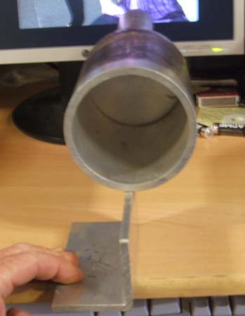

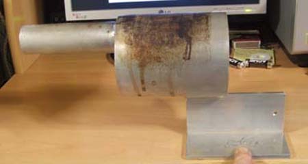

Also you say you use a stainless pipe for your bending, try using a mild steel pipe (just clean it up first with some wet & dry). Stainless is notoriously bad for heat conduction and I suspect that unless you are bending directly on the spot that is being heated (by a gas torch I suspect?), that even a little way from that point there will be a difference in temperature enough to cause temperature differences in your wood. It may 'feel' even but if you used a high temperature pyrometer to measure surface temp that there will be a variation of more than a few degrees on the surface I suspect.
If you want to keep a pipe bender make it aluminium or steel . The heat goes straight through S/S and it doesn't become a heat sink. As soon as you put your wet timber on there you suck the heat out of the hottest spot . As for side benders my experience with light bulbs was of not enough heat making it hard to do nicely. Waiting on a bending blanket now from MEI.
