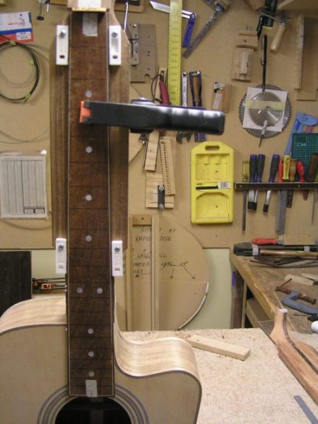

I just glued the fingerboards to dreadnoughts 6 & 7 and used a different process again, which might be of interest to someone as I haven't seen it elsewhere. But for a laugh, here is a summary of my evolution on this front over the last 4 years.
Dread #1 - freehand gluing to pencil lines - say no more
Dreads 2 to 5 - two brads in fret slots - much better but still got more movement than I wanted, and had to line up the holes in the caul with the brads etc. etc. i.e. still not satisfied.

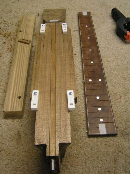

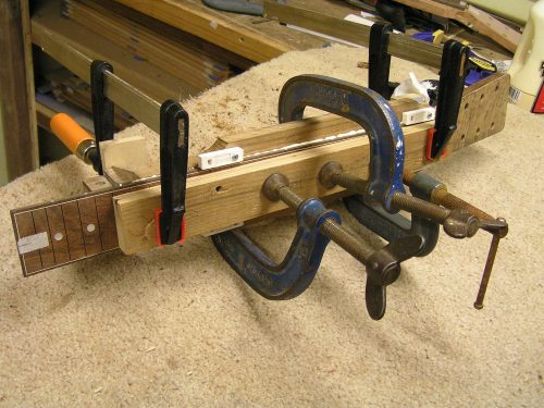

Dreads 6 & 7 - the pictures tell the story. The white plastic blocks were spacers that came with some window locks I fitted at home. They have enlarged screw holes to allow rough placement & then pull them in real tight against the fingerboard. Worked like a charm on both guitars. I'm sure others do it something like this, but I just hadn't come across it. Nice and simple. The kerfing I used is also 3/16" so makes a good nut spacer.
