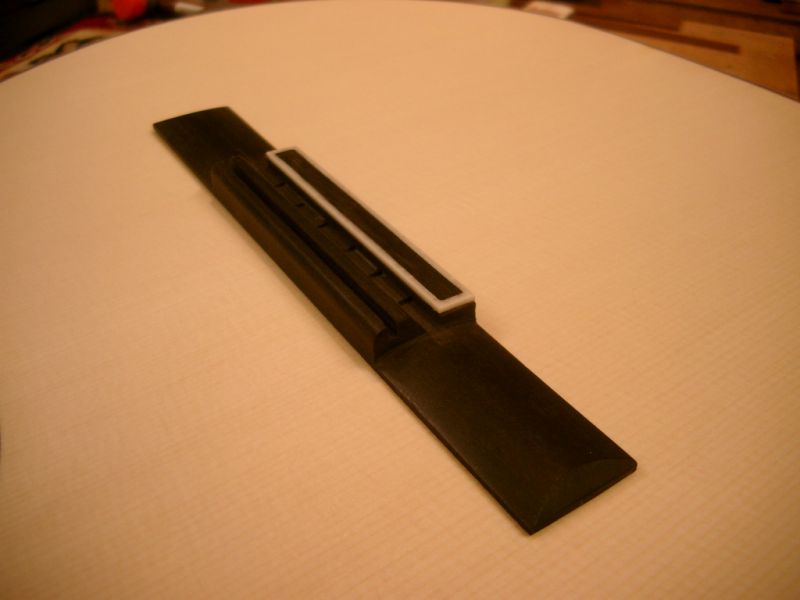

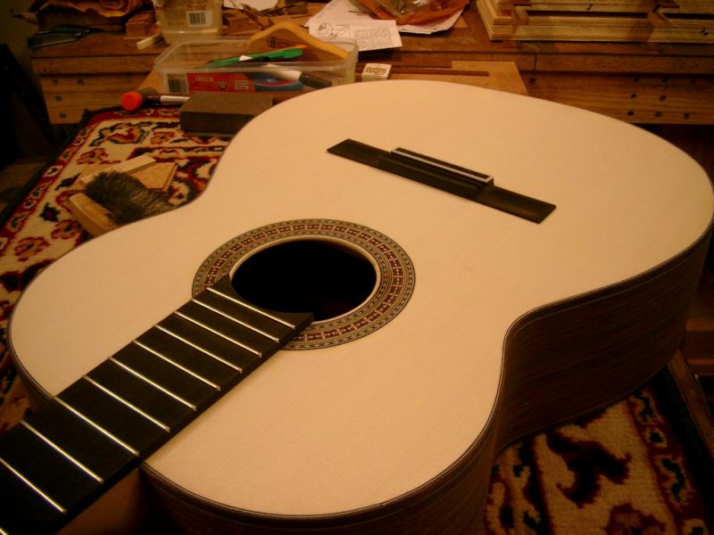

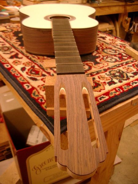

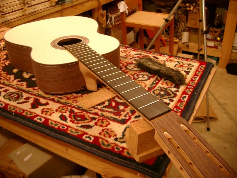

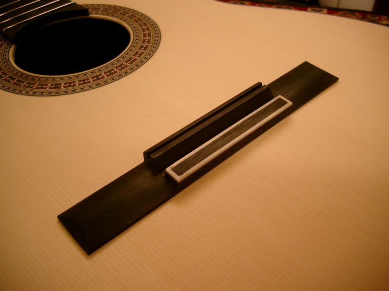

I had planned a full day in the workshop but as usual it didnt happen. The 3 tonne load of firewood that was supposed to have arrived yesterday arrived today and half the day was spent stacking the stuff. Anyway I did get a quick fret job done on the classical. The bridge is sitting loose on the top...it wont get glued on till the instrument is french polished. The Englemann top has been sanded back to 180grit and it looks great...Graham Heins Englemann is simply great wood. For those wondering about the brown coloured patches on the bindings...its a epoxy/rosewood dust touch up job where binding didnt quite seat fully.

Looks great Martin, very clean and neat lines. The headstock looks very accurate. Same with the bridge. Nice work.
So, another 3 tonnes of 'firewood' eh. :wink: Sure it wasn't another 3 tonnes of AAA engleman you were stacking Martin.

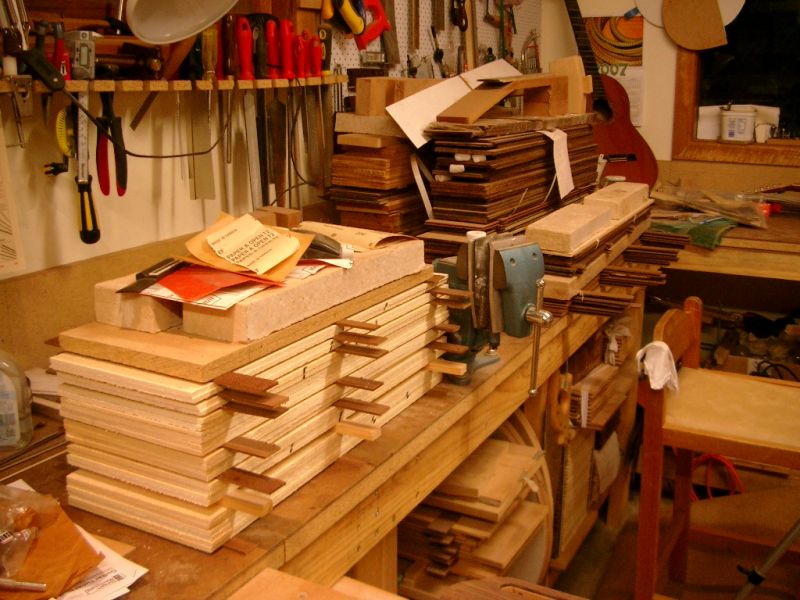

Not quite 3 tonnes but enough to cause some serious bench space issues. In the foreground is the latest delivery of Englemann from Graham.

wow, i wish I had that sort of a wood collection. I mean, look at it all!
Great work Martin, I love the binding on the bridge ;)

Beautiful work on that there classical. Englemann offsets Indian so beautifully and I love large bold rosettes. Is that a Spanish Cedar neck or something else? What build style did you follow for this one - as in Torres, Hauser etc... Ode to more time in the workshop that's for sure. Some more firewood wouldn't go astray either - we've already been sub zero and it's not winter yet!

Yes the neck is Spanish Cedar. The rosette is a stock item from Stewmac. Build style.....basically Torres but this instrument has very low profile fan struts after Hauser.
The IRW is opp grade from Allied. I have a fair stash of the stuff and IMo its great value for money. It has a few knots and other blemishes but for classicals you can easily work around same.
This is my first time using Englemann..previous classicals have had Sitka tops. Will be interesting comparing sound of my previous builds to this instrument.

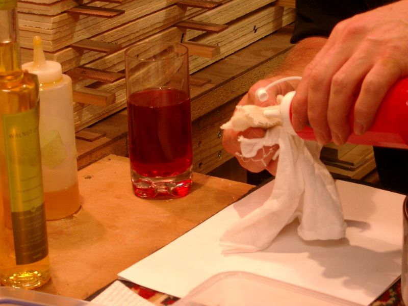

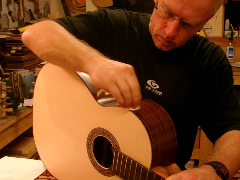

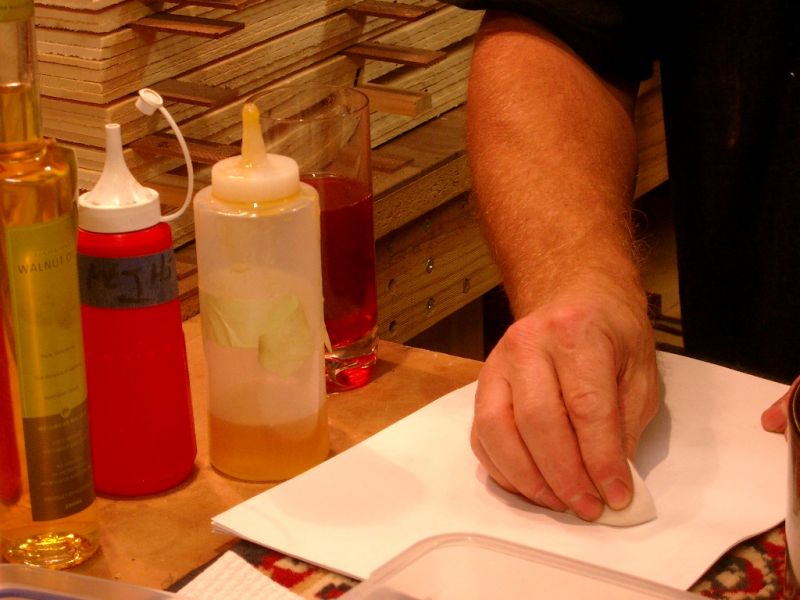

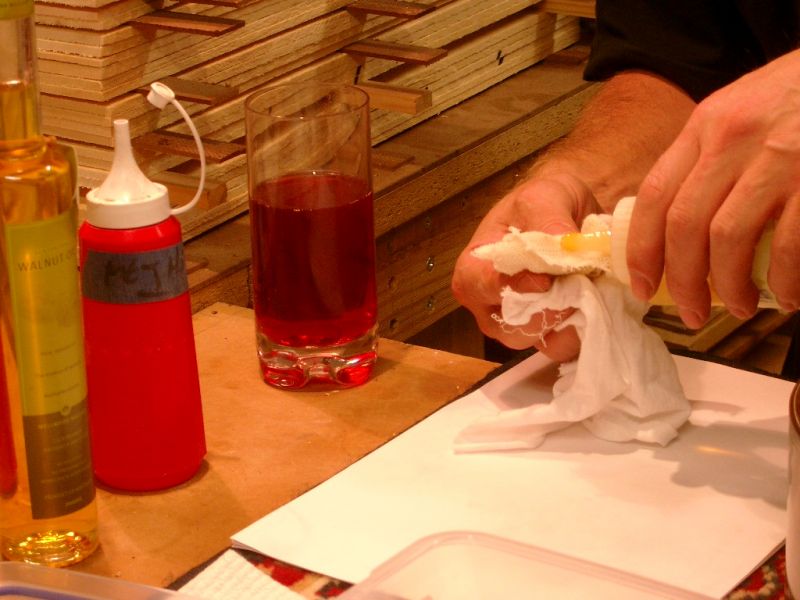

French polishing in progress on No 6. Pore filling went ok but there was a bit too much leaching out of colour on the back for my liking. Pics of body sessions in progress. My munecas are cheesecloth from local paint shop and the outer layer is well used T shirt material. The shellac is LMI super blonde and the oil Im using is walnut oil from Victoria.....Ive just started using it after trying olive oil and baby oil.
A few drops of meths..IMS grade. I charge up the meths and shellac direct to the wadding rather than onto the face of the muneca ala Milburn Bros Tute.
A few drops of shellac. Im using a 2 lb cut from the bottle which gets diluted on the pad to somewhere in between 1 and 2lb cut. The purple stuff in the glass....vodka and cranberry juice (ran out of soda water and couldnt be bothered going to the shops). On the chair in the background is "Arnie the Armadillo" with the cardboard template for the first rib pinned on.
The muneca gets tamped on typing paper until it gives a patchy impression on the paper. Once Im happy a few drops of walnut oil go on the pad.

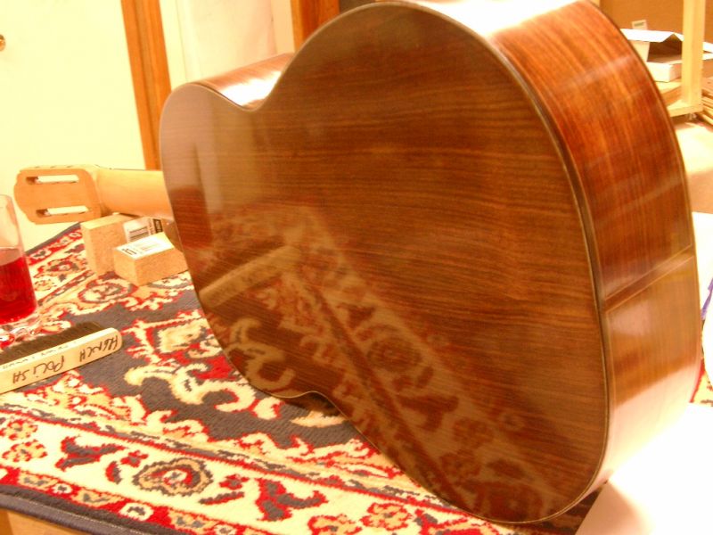

Working on the back. You can make out the filmy plume that tells me the shellac is going on. The analogy is the film a car windscreen wiper leaves on a windscreen that has a bit of oil on it.
Working on the sides.
Look at that reflection! This is after two bodying sessions.
