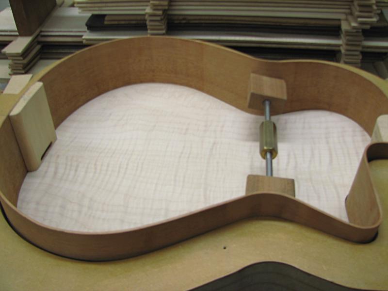

So far I have the sides bent (nothing new in this picture!)
The spare neck & tailblock were just there as packers at this stage.

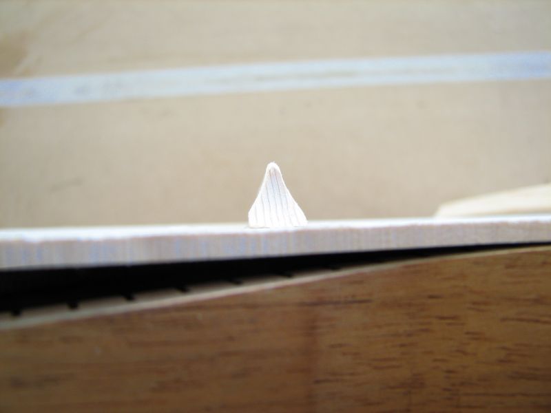

In order to keep the box a reasonable & comfortable size I made the sides wider by 8mm so it didn't feel too big for the player (hopefully they don't feel any difference) but retain most of the original internal volume of the box. I have decided to have 16mm between the two backs so the inner back is in by 8mm from standard. Some shots showing the profile of the sides.

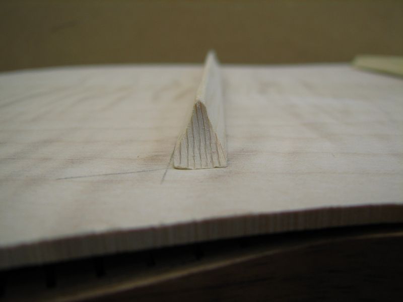

To get the inner back following the outer I marked a line parallel & 13.5mm in from the back (+2.5mm thickness for the maple gives me the 16mm), this gives me a line for the top face of the linings to follow. The sides are sitting in my dish that has the correct arching/shape on it so providing my sides match the dish, the pencil must follow the same profile.
Because the linings act as spacers as well as corner fillets I made my own so that I could put a 'shelf' on the top for the inner face to sit on and glue to.I also made the kerfing 4mm instead of the standard 6mm so that the lining better followed the tight curve of the upper bout cutaway 'point'.
Thinking also that once both backs are glued on, the air space between them would be sealed & effectively a closed chamber, which would act as a dampener/compressor. I added slots at each of the blocks to allow air to move freely between chambers. Here's a shot showing that and also the linings I came up with. I glued them onto the head & Tail blocks to give the inner back something to glue to in these areas.

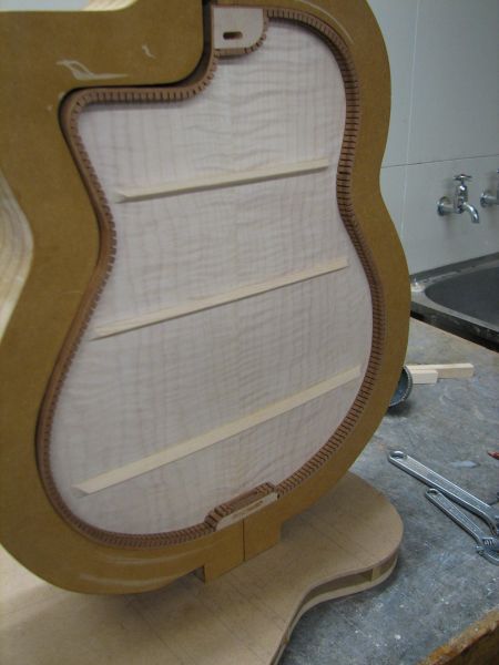

Well here I am at the next stage of the build, the inner back halves have been jointed and I've cut the outline to roughly the outside dimensions of the sides. Once it's been braced I'll sit it on the back of the guitar and add a temporary brace down the length to simulate the final back curve. Then working off the sides (as reference), mark an outline 2mm in (the thickness of my sides) around the perimeter.This should, hopefully :oops: give me a back that fits neatly inside the box without gaps between it & the sides.
Some more pickies for your perusal.

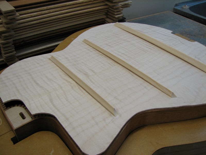

The three inner back braces just sitting on the curly maple back before gluing, they have a 12 foot concave radius to them. The tailblock end brace is wider (by 3mm) than the other two to hopefully add a little extra mass across the lower bout to bolster up & focus the bass response of the plate.
I haven't taken them right to the edge so that it will give me some room to add a recurve if needed to the back to make it responsive.
I've also scooped the sides of the braces and triangulated them to lighten them but still retain some longtitudinal strength and hence their curve/shape.
Another blurry shot :lol: sort of showing the same thing.

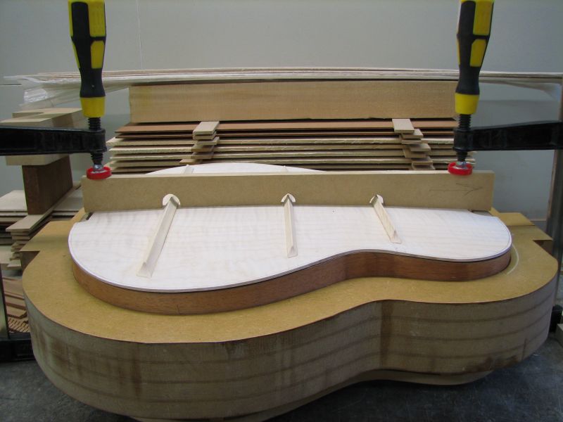

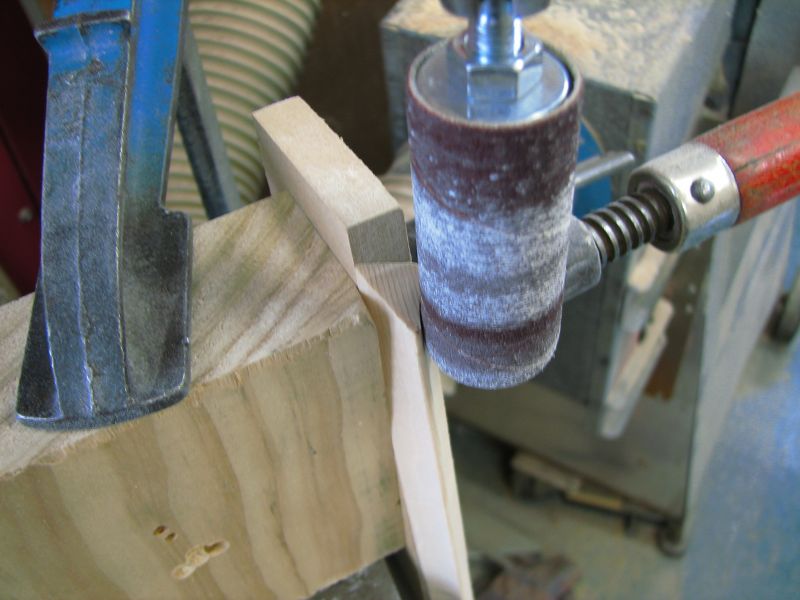

Then finally a shot for the jig perves (you know who you are!) my rough and ready method for shaping the curved/scooped sides on the braces. The MDF behind the brace has the same 12' curve as the bottom of the braces so that the braces "rolls" past the sanding drum at the same height all the time.
Like I say, it's real rough and ready, I may never reproduce this style of brace again so I couldn't see the point of making a permanent jig :cry: (does that make me a luthiery outcast?? :) )

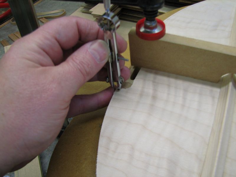

Once the inner back was trimmed, I set the compass to 2mm and followed the sides around, this hopefully would give me the right shape of the inside at the shelf where this back will sit.
Once I had this line I carefully belt & drum sanded it back. There are still a few gaps between the inner back & sides due to having to remove the spreaders to fit the inner back in, & it never sat back in the mold exactly the same as I had it before removing them. I'm hand sanding the high spots down & things are getting closer to where I want them to be.

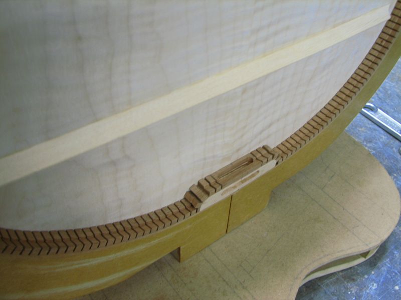

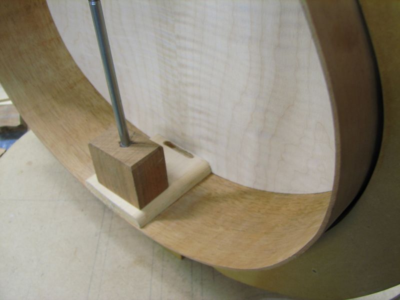

From the back with the inner back sitting on it's 'shelf'
The "air" slot in the tailblock end from both sides of the inner back.
a slightly blurry picture of how it will look once it's all glued in.

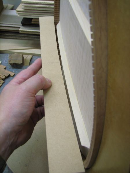

& finally a shot showing the gap between the two back plates using my radiused MDF form to represent the radius of the outer back.
