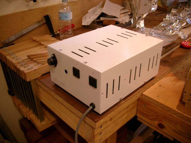

MEI's controller is in the $500 mark. Very pricey, but undoubtably works well, and easy to set up. There are other options out there to set the thermocouple up, but I've not explored them. I believe Kim has, so may be of some help.
I got the blanket with the thermocouple on it, thinking I would be using it. Now, I wouldn't get one installed, as for the way I bend, I just don't see the need.
These things are priced like a nice back and side set. Easy to justify the cost of them when you factor in how easy it is to bend a side set without breaking them.

I've got an old cloths dryer under the house. I've heard people suggest they are a good source of stainless for slats. I've not really investigated this yet.
But they also have a timer and a thermostat for 240v. Seems like there are always a few for free on suburban verges too.
Its been in the back of my mind for a while now to try use these parts. Anyone know why this may not work?

I really don't think you need the controller for the blanket.
I made one from a Dick Smith kit and it's still attached to the blanket when I bend but I don't use it at all.
If you can get down to Geelong one weekend you can have a go at bending a few sides to see how easy and inexpensive it is with just the blanket.

I bought a standard light switch box and switch. The type that are installed in every house in Australia. Went to the Tip buy back shop and got a long power cord from a computer power supply for $1. Then wired the blanket and power cord to the light switch box. The box is mounted to a board so its easy to set down on the bench.
If hooking something up like this is too daunting for you, any Sparky should be able to do it for you for a very minimal charge.
I also got one of the digital thermometers from Dick Smith that Bob recommended. So now there is nothing more complicated than turn on blanket for 2 minutes. Watch temperature climb to 100 degrees C. Bend, and turn off blanket at 150 degrees C.
If the bending is taking longer than planned its easy as to turn blanket on and off to cycle the heat.
I always unplug the blanket when the bending is done. These blankets get really hot very fast, and it's too easy to have something unforeseen happen, and start a fire.
