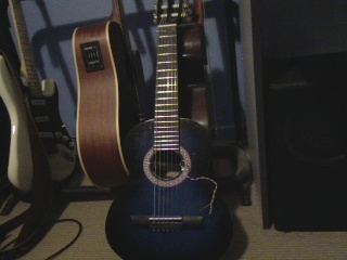

I'm having some real trouble with the intonation on a miniature (1/2 size?) 'guitar' I acquired. I realise these things are banged together in china for about 20c a pop and don't expect much from it... but it is a great size for taking traveling, and i don't have to worry if it gets knocked around a little.
The thing that's got me stumped is that when i first got it the intonation was almost perfect... it was as good as any equally tempered instrument i'd heard, (the other 5 'identical' guitars in the shop were rubbish!) but it seemed they'd gotten one right. so i handed over my $18 and went home happy. Played it quite a lot, sounded great... (well... sounded in tune, rather. :wink: ) and everyone had a lot of fun singing along to the silly guitar.
THEN... I got a dumb idea. "It's not very loud... what if i but a pick-up in it?" ..."i have a few spares, and some jacks, and pots, i could amplify it and more people can sing!"
All of which went quite well... until it was time to re-string it. Since i just bolted a standard electric guitar pick-up to the soundhole, it seemed logical that i would need to put some steel strings on it, rather then the fishing line it came with (I quite like nylon strings... but i'm pretty sure those things weren't nylon...!)
chucked the strings on plugged it in... woohoo sound!

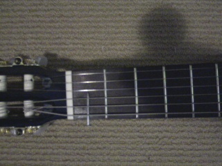

i tried using a nail as a temporary nut to find where i might need to relocate the nut to... but the 12th fret didn't sound in tune until the nut was moved about 14mm!! half-way to the first fret!

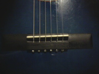

Is the bridge compensated? Is the saddle parallel to the nut, or does is get longer on towards the low E side?
More info needed, and I'm sure that some of the brighter members here will be able to help out.
I've set up the permissions for you to upload pictures, so if you can post a picture of the instrument, it may be of help.

Yes, is a very cheap nylon string which I have put some very light steel strings on.
I had hoped that the fact that it is basically a toy, and such a short scale, that the body would hold up ok to the steel strings.
as for the bridge being re-enforced... I haven't done anything to it?
I the soundboard does flex a little if you bend a string, pulling the others temporarily out of tune, like a very primitive vibrato set-up.
The saddle is very slightly angled to be longer at the low E... but only by about 2mm?

I've attached a picture of the bridge, and of where abouts my nail has to be to get the 12th fret playing an octave on the low E string.
Image[/quote]
Hello Adam, With those measurements it wouldn't have had correct intonation to start with.The 12th fret should be at 412.5mm which looks about right with your nail test.Cheers.
