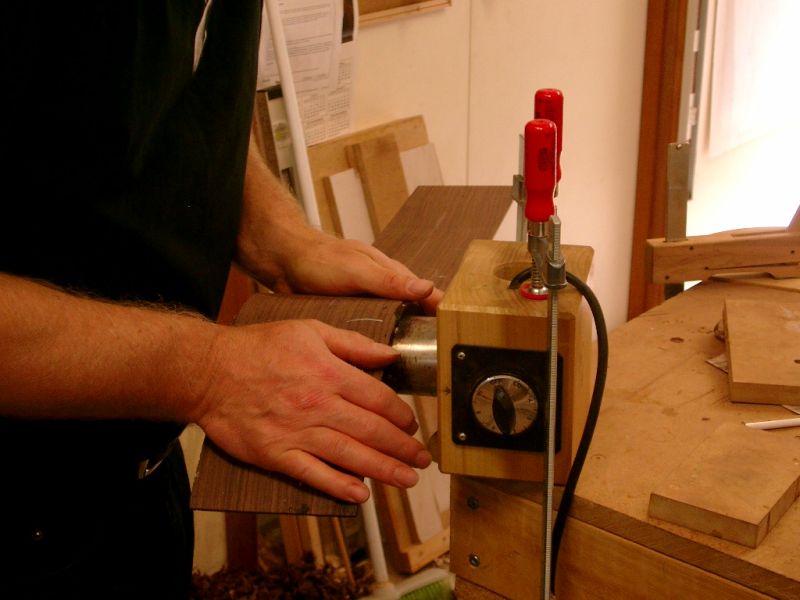

The important thing is to have the pipe hot enough. Water sprayed onto the pipe has to bounce off, over enough of the pipe that is the width of the sides. Spray both sides of the wood to be bent and as it evaporates off the outside re-spray both sides. Check regularly (by spraying a little) that the pipe hasn't cooled down too much and don't try to bend one spot. Rock the wood over the pipe so 75-100mm / 3-4" at a time is being heated.

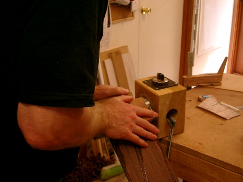

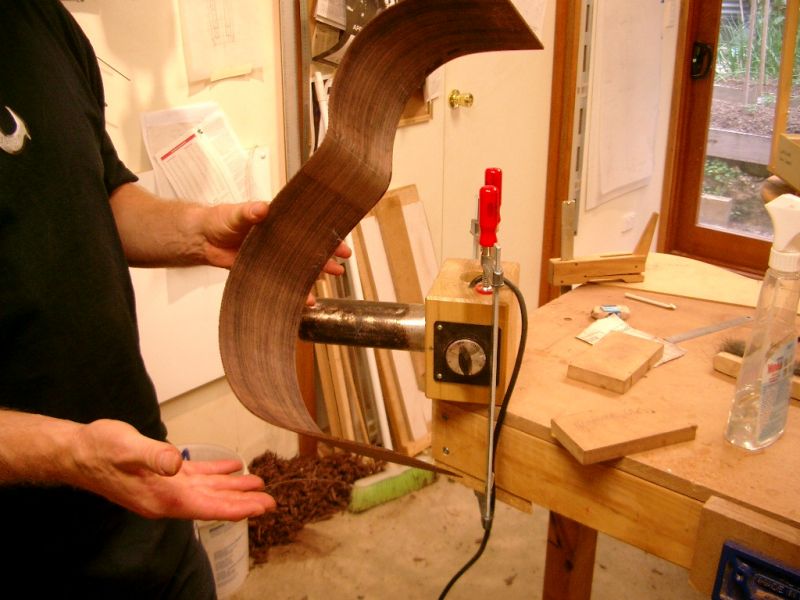

Nice job Martin! but listen very carefully, I shall say zis only once.................................................................................... you've bent a left handed side rather than a right
And if you're french where eeze zee Beret monsieur? No self respecting frenchman would be seen dead without 'is 'at!

Cheers and thanks again.... the 2nd side was so much easier tonight, and a much better looking side (this guitar still won't win any beauty contests). I think having a cold one beforehand helped, as did wearing pants, but in reality it was the advice and confidence I was given over the past 24 hrs that amde the difference, this place is great.
