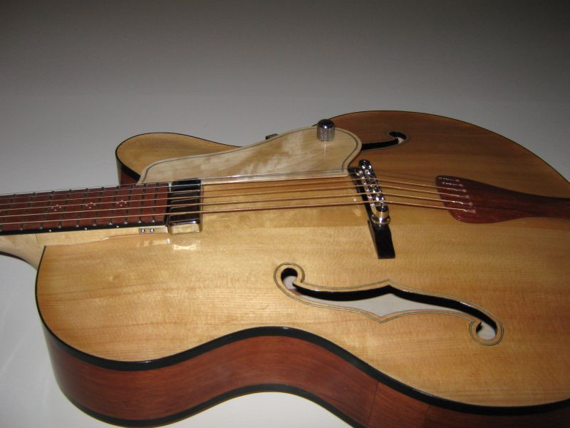

I cleaned up the extra duplicate posts you made Rocket. Great looking guitar there.

Post by Stu » Tue May 05, 2009 6:25 pm
Welcome to the forum,Rocket.
Nice archtop there also. :D

nice looking guitar!
Welcome to the forums :D
Post by DarwinStrings » Tue May 05, 2009 8:54 pm

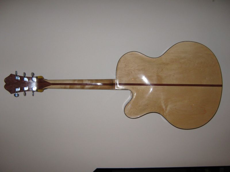

Very retro Rocket, looks as cool as a jazz solo. I like the way the stripe spreads out onto the head stock and the wood scratch guard.
Post by ozziebluesman » Tue May 05, 2009 10:51 pm
Very nice jazz machine indeed. Welcome to the forum Rocket!

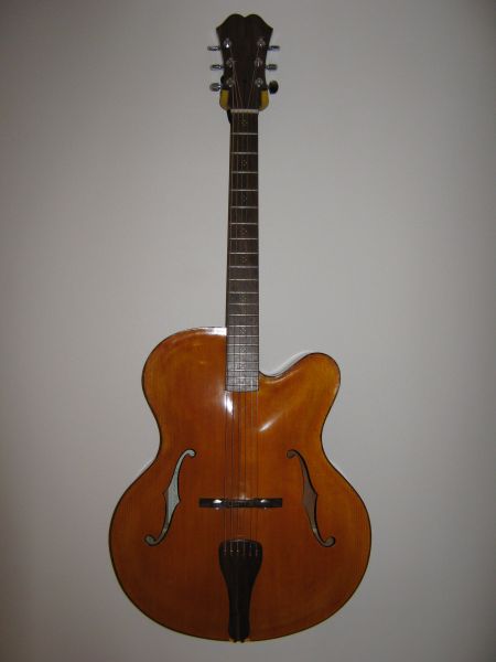

Ok i managed to get this one uploaded, it's my fist guitar.
i'll see if i can get the other instrument on here!

Couple of nice axes there Rocket, the soundboard on your first...is it Spruce or another wood? Or is it just the way it's finished? Also how did you brace them, did you use the 'X' bracing or the parallel?
I like the insert down the centre of the soundboard on your second BTW.

Thanks Nick, Yeah the top is sitka spruce, finished in shellack with a bit of yellow tint added. The back and sides are Figian mahogany, parralell bracing. The second guitar is sitka spruce with x bracing,with rock maple back,jarrah sides, maple and jarrah 3 piece neckand jarrah head stock veneer. finished in super blonde shellack. To me i think number 2 sounds more crisp and pewerfull, hope it's the bracing but the timber has something to do with it.
Post by Nick » Thu May 07, 2009 6:25 pm
Thanks Rocket for clearing that up, the first looked quite dark which got me wondering but the Shellac would explain it.
I would say it's more a case of woods used on your second that would give it that crisp sound because usually it's the other way around with the X giving a more mellow tone, along with the bracing the top is thicker & slightly less responsive. My parallel braced just jumps with 'fresh crispness' & snap, crackle, pop :D compared to the X braced, having said that string choice can make a difference too, flatwounds (more mellow) as compared to roundwounds (bright). I compromise and use half rounds 8)
