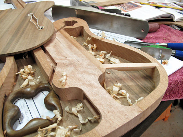

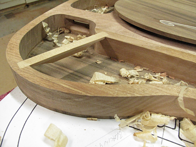

A little something for someone out there..............
Cheers, Stu

Jim, This one is a neck through construction hollow telecaster build.
I'll post more a little later, got to get to work now.
Post by Nick » Tue May 05, 2009 5:54 am
One serious looking tele there Stu, along with Jim I would love to see more pics, Walnut top? (and as if by magic you post another whilst I type :) )

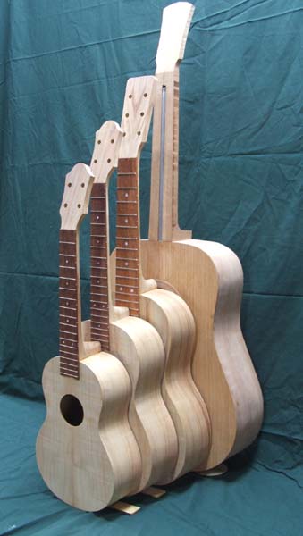

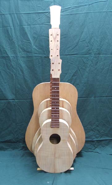

Things of all sizes on the bench at the moment.A Dread. , 3/4 Style 5 . Baritone and Tenor ukes.Been checking out the Kent Everett DVDs and he seems to have a good idea of what is going on.Seems 30 odd years as an apprenticeship really works.

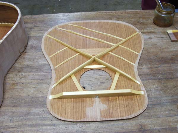

And here's the top bracing (reluctant to show it, but what the heck)

I do like the look of Rod's soundboard bracing. Food for thought in that one. An original or from someone else?

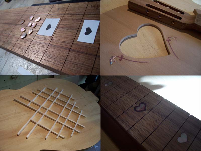

This is a nylon string with a shortened scale for my almost seven year old daughter, she requested flowers and hearts. The flowers that are the sound hole rosette(sort of) were designed by her , I will also put some of them on the headstock. Oh and she hasn't started to learn yet :D

Jim, as Kim on Kath & Kim would say.........Nice, Nice,it's unuuusual! I love your rosette/soundhole combi, even if your daughter doesn't take up the instrument fully she will certainly end up with a beaut guitar. Love to see it when you've completed it.

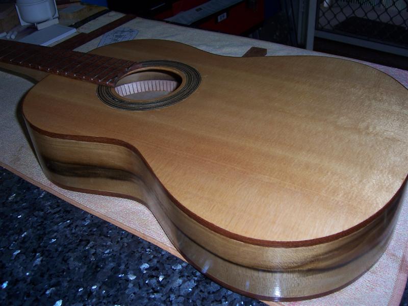

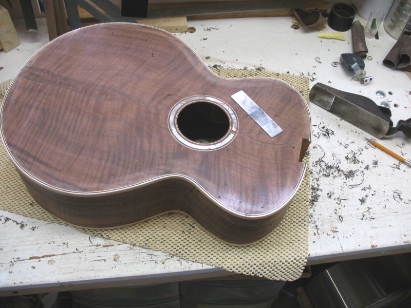

Just scraping bindings on another L-1. This one is all "California Koa"... OK, just walnut, but after the post of the gorgeous guitar with King Billy Pine I guess I got a bit envious of the really cool name. Great seeing the things people are working on.

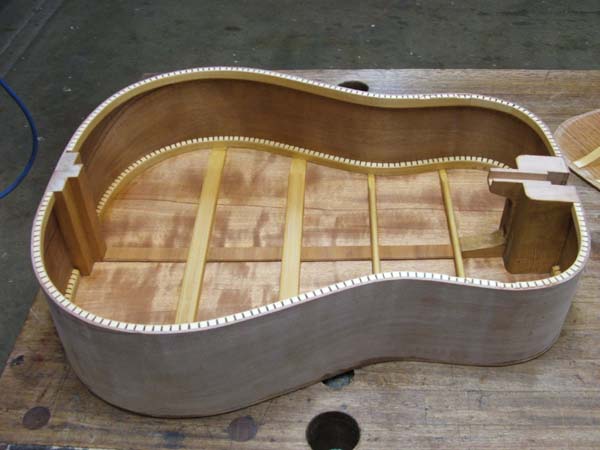

Onto my second Uke.
One side finished.
The other side drying in the press.
Back material. veneer
Sound board material. solid sepele
The press I use.
The drum sander I use.

Thanks Graham.
Well, I've not seen one like this before. I've seen variations of the double X-brace but all of those have seen the secondary X-brace much lower in the bout and also much heavier. And than there is the full lattice braced tops. Nope, I like to think this is mostly original with a little bit of outside influence. Certainly nothing I've ever heard before on a completed instrument.
My main brace is also splayed alot (measures at 112*) and is also pretty light at 1/4" wide by 1/2" at the intersection, tapering at the lower bout to nothing. The secondary X-brace is 3/16" wide by 1/4" hight at the intersection, tapering at the lower bout to nothing. The bridge plate is BRW and is only 1/16" thick. Thinner than most "plans" for sure and most "suggested".
The tap tone is the best I've ever come up with. Very bell like and rings for quite a long time. Yet when I tap it in the lower bout it drones like the drones on a bag pipe. I've very excited about this top.

I agree there Rod, I've seen the double cross before but not quite as fine as yours looks and not with that horizontal member between the lower arms of the lower cross, you are a brave man mate and that rosette is very pretty. If possible I would like to book a sound demo on that one please Rod. I am curious about how thick you are leaving the sound board and why you were reluctant to show it?
I meant to add that 'Californian Koa' makes a great looking soundboard too John.

Well, one never knows who lurks on the forums and sometimes it's hard for me to post pictures of my bracing. I know that I do things a little different (just a little though, not a ton) and honestly, I have very little answers for why I do something other than to try something new. That's why I'm reluctant at times. As for the soundboard thickness. It's at 0.098". This is one stiff lutz spruce top and with the secondary X-brace tucked up behind the belly of the bridge, I think it will stay plenty strong to resist belling (of a large amount). The other side of this is that I'm really working on coming up with "MY Sound" for my guitars and posting pictures of one's bracing design is sort of like the DNA strand, or a good portion of it anyway.

More power to you for the design. It just looks like it should work, so don't feel nervous about having people look at it. I use a hybrid X/lattice design on my pin bridge bouzoukis and I keep on coming across people who say it won't work though after 15 years or so I reckon it does.
There will always be people out there who will dismiss original thinking in guitar design because Martin/ Gibson etc didn't do it that way. Some ideas will work, some won't and I have certainly come up with lots of ideas over the years which 'seemed like a good idea at the time' and subsequently proved a little less viable :(
It is an interesting comparison with Allen's much heavier standard X bracing.

Impressive "little something" Stu...? little something... sheesh.... The hollow is for weight or is there a tone imperative?
You got a lucky daughter Jim, I look forward to the finished photos
Eeeeeewwww John, that looks so sweet. I reckon there are a lot of unexplored tonewood combinations.

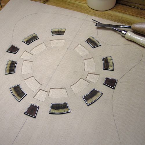

I am currently working on a variety of projects. This is a rosette I had recently completed on a bouzouki I am building - (yes I've used it as my avatar). Here it is ready to glue up -
Now here it is glued in and sanded level.
It's Ring Gidgee and Ring Mulga with mitred purfling on each piece. It was fiddly and time consuming also because the individual pieces are made up of several tiles each.
Nice to see some current work Mike! Though I'm a bit concerned about those Localeles of yours - they appear to be breeding, and getting BIGGER :shock:
