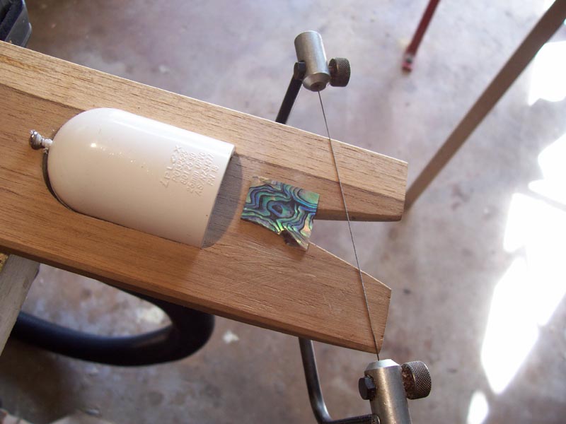

The method in the pic solved all pearl dust problems but as kim says hold onto your workpiece, I have lost the odd bit up the pipe. Also I use kims method of the fan from behind as well as a bit to the side then just blow the work every now and then when cutting pockets, I don't get dust in my eyes at all. I'm not sure how your eyes are Hip but nowdays I wear two pairs of reading type magnifying glasses( my partner calls me six eyes) it looks silly but I get a 5x mag with a set of 2x and a set of 3x, just the $7 ones from Crazy Clarks as they don't seal they don't fog.
