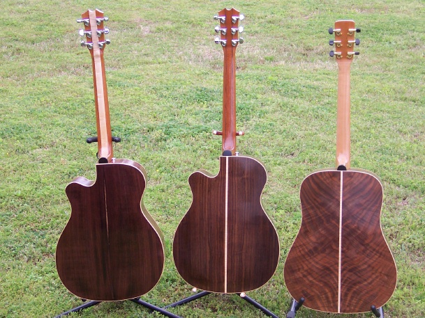

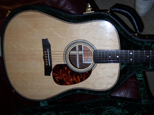

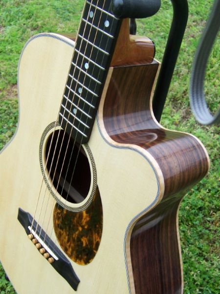

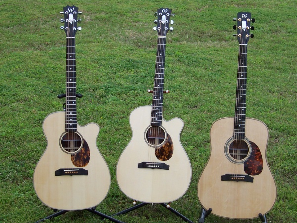

Well, the photos aren't very good, but here's what I've been up to for the past 8 months.
Nearly twin OM cutaways of EIR with German spruce tops and curly maple binding. One neck is mahogany with two strips of walnut but it doesn't show up in the photo. The other neck is walnut with a wide strip of birds-eye maple. Both also have K&K mini pickups installed. They sound great with and without the amp. This was my first attempt at a cutaway. Both are gifts for former students.

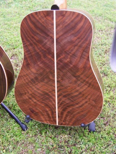

The dread is claro walnut with a sitka bearclaw top and curly maple binding. It is a gift for my brother in law.
Ron

Nice work Ron...love the bearclaw on the Dreadie.

How did you find doing your first cutaways? They look very well done. A nice balanced shape, and that Dread is just stunning.
What do you think of German Spruce. I've got a OOO and OM to build with it at the moment, and have never used it before.
Very lucky students and brother in-law.

Post by Ron Wisdom » Sun Apr 19, 2009 6:46 am
Thanks, guys. I'm glad to be finished with this lot. Three at a time is too much when there is a deadline (graduation).
Allen, the cutaways came out really nice, but it was a lot of work cause I had to build a new bending form and make an insert for my OM mold. I won't do another, though, unless it is a paying customer. :?
The German spruce is nice. It and lutz both seem quite a bit softer than sitka, although they are stiff and sound good. I prefer working with sitka.
Ron

:cl :cl :cl Nice job Ron. The dread has some lovely timber combinations. The Claro and Bearclaw just wonderful, not a dready fan but I'd be pleased as punch to own one as good looking as that. Great looking cutaways too and well done on tackling 3 guitars at once.

Agree with all of the above comments. The dready is really nice and what a nice piece of Walnut. I don't know why people don't like them.

I'll second that Ron . In fact , a bit of an understatement :lol: It always amazes me how little some charge to upgrade to a cutaway.
You should be very proud of this trio Ron . They all represent superb craftsmanship. Three at a time would be too much for me to handle also. Man that's a lot of time and effort , but well worth it when you end up with these three beauties .
The finish is impressive too. What is it ? . I'm not normally a fan on scratch plates , but yours really suit these guitars. Where are they from ?
You say the O M's are almost twins , but do they sound the same ?
Beautiful work Ron. :cl :cl :cl

Craig, the finish is tru-oil. The pick guards all came from LMI. The dread is just one of the cheapo things, but the OM's are the very expensive tor-tis. I would have used a cheapo for the OMs if they had the right size in that material.
Hard to describe the sound, as I only strung them up today. I really can't tell any difference in the sound quality of them, but one "seems" a tad louder than the other.
Also, I don't think I mentioned that the neck on the dread is cherry. I really love the feel of the cherry neck, no pores and it finished as smooth as a baby's butt.

Im impressed mate. Particularly the dred, that bearclaw is insane as is the Walnut.

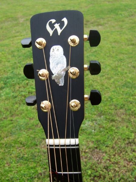

Really, really nice work, Ron! Like the headstock shape on the OMs a lot.
