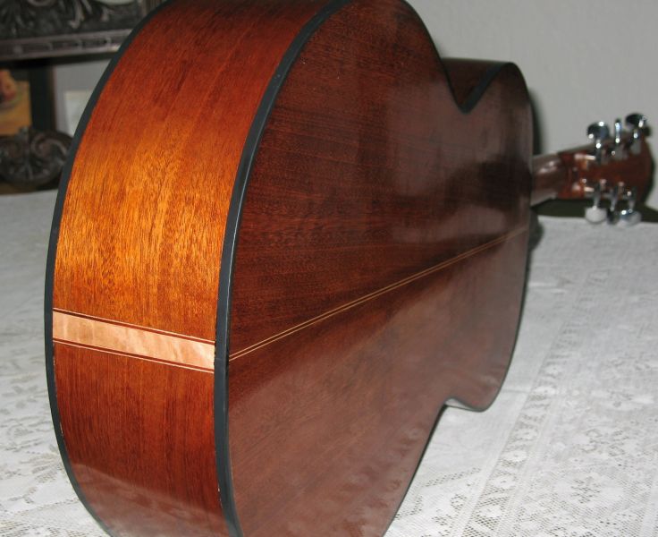

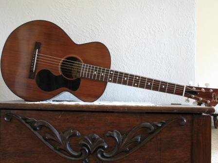

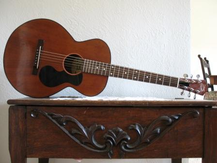

I have been watching the site for a few weeks and after seeing all the interest in Ukes and small bodied guitars I thought I would post my latest two. Based on a 1926 L1, both have Mahogany back, sides & neck. One has a Mahogany top, while the other has a redwood top. 24.5" scale, 12 fret @ body. All Mahogany weighs in at 1500 grams total, the other 1360 grams. My first attempt at small bodied instruments. Lil' buggers really bounce when played! Already started #3 LOL. Great site, you all are a hoot!

Your guitars are indeed little beauties, I particularly like your headstock design, small with a nice taper outwards which reminds me alot of Lutes e.t.c. Your pictures aren't close ups but your work looks well executed from what I can see. Nice job :cl :cl

Sweet looking instruments mate, can you get any more close up photos? Love them pickguards.

I absolutely adore little guitars. But these are just teaser shots. You've got us interested, now common. Some close ups of the details. They look too good to not get the attention they deserve.

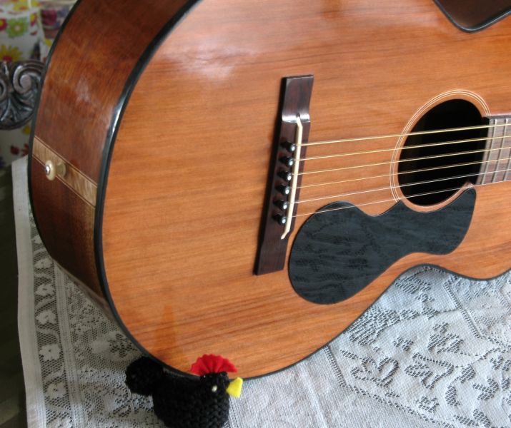

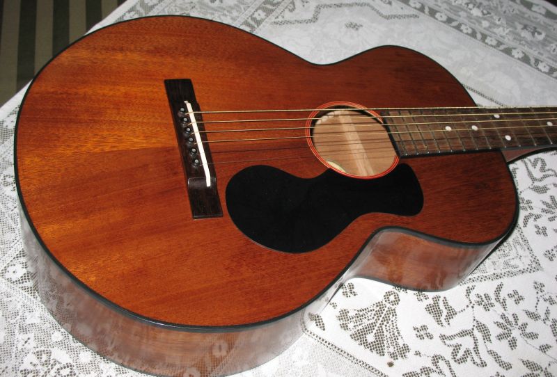

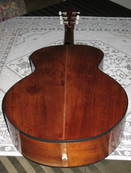

A few more pics as requested. Sorry about the poor photogragphy skills. (Chicken courtesy "Emma" from across the street).Someone asked where my plans were from. Drew them up myself. Found the best straight-away picture of an L1 I could find and blew it up to match known dimensions (scale length) Then just went into my CAD program and did the rest. As the pics will show, the binding job could have turned out better.... :oops:
While both have identical woods except for top wood, they each very different characters. Can't decide which I like more. The All Mahogany gets played more, tho... :wink:

I also like your guitar stand in the first pics.
I gotta get one of those.
