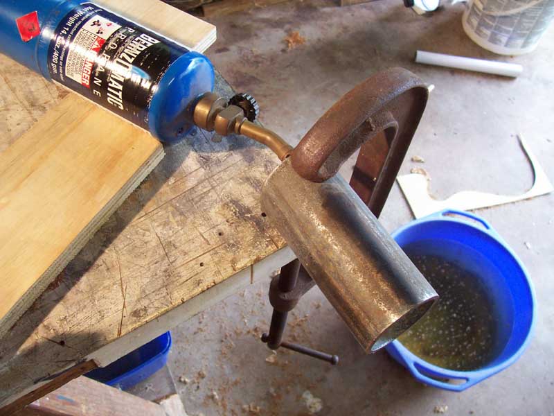

Post by ozziebluesman » Sat May 02, 2009 6:54 am
Tim here is a pic of my side bending session on the sapele. The electric bending iron is featured. Buy there at LMI, Stew Mac or ALS in Oz for around $250. They work well.
Most on the Uke Talk forum go with 1.6 mm as standard thickness and you can go as low as you feel game. Depends on the wood used! Just over 1mm will give you nice responsive uke using hardwood for a top. I haven't ventured that thin yet.

Tim, this is my side bending iron from ElCheapo Inc.
