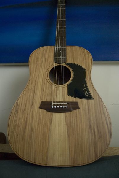

Todd: I love the bunya top on the cole clark.
