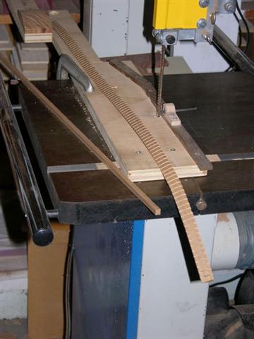

Post by Taffy Evans » Tue Apr 14, 2009 10:49 am
Hi My experience with spruce and Cedar is that they can be a bit fragile when working with them, particually when cutting the kerfing. I use a timber that has the name "Damar" or something in the name bought it many years ago so Im not sure. Works well for me', I dont look for tonal qualities in the area.
Posts: 1076
Post by Taffy Evans » Tue Apr 14, 2009 11:04 am
Hi again, I found a photo of the lining timber I use.

Thanks so much for the input, all of you. Taffy, when I cut kerfing I will use your band saw jig design to do it.
