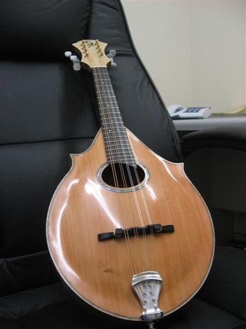

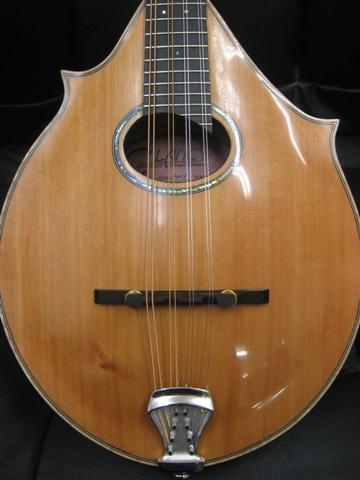

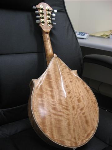

Following the completion of my first instrument, a carved 17" archtop, I was asked by a friend to make her a carved mandolin to replace her cheap chinese one.
We struck a deal where she would pay for materials and I would do the build for free, thereby gaining more experience without too much overhead costs (of course I had to make new molds and get a couple of new tools).
I don't know much about mandolins so I used Graham's new mandolin book as my guide and consulted him occassionally (thanks graham, I'll be phoning you tonight to see if your free for me to bring the mandolin around)
I've taken the mandolin to the local music shop for a real try out and was told it sounds lovely and plays very nicely (but will rely on Graham's opinion as my benchmark).
Enough gabbing - here's the pics
oh yeah
top - King Billy (from Gilet)
back, sides, neck - Qld Maple (from a local timber yard - right place, right time)
fretboard - ebony
binding & headstock - figured maple

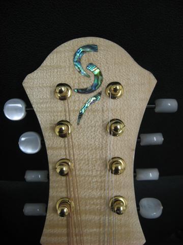

Headstock inlay - from jim (cheers mate, first inlay attempt went well, nothing flash on my part but looks good)

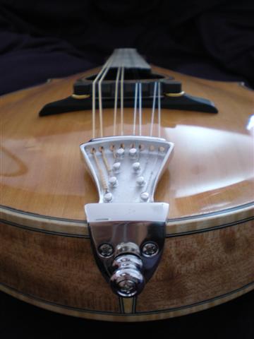

Also,
Wanted to use a gold tailpiece but couldn't afford it.
This is a 2nd that was cheaper again on the Allen website's 'Deal of the Day'.
Posts: 1079
Post by Taffy Evans » Thu Apr 09, 2009 9:01 am
Very, very nice Craig. Your first time efforts are very impressive with good detail and clean workmanship, I like this one.

Post by ozziebluesman » Thu Apr 09, 2009 9:54 am
Very nice indeed Craig. Thanks for the pics. King Billy pine seems to be popping up in a few builds lately. I have to agree your first inlay job looks great and adds class to the instrument.

Looks like you've made a mistake Craig, do you realise what will happen when Martin sees this. Once again your work is very nice and the headstock inlay is just the sort of thing I like to see.

Really nice!! That inlay is really clean in that light colored headstock. Great job.

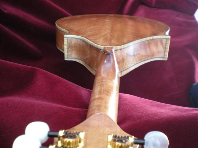

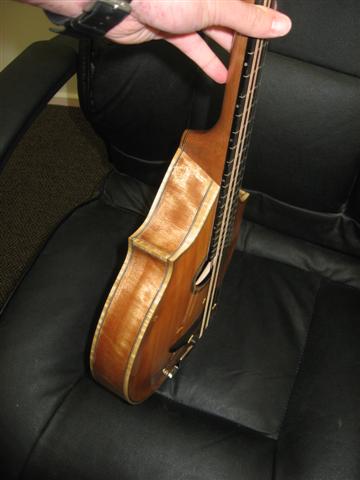

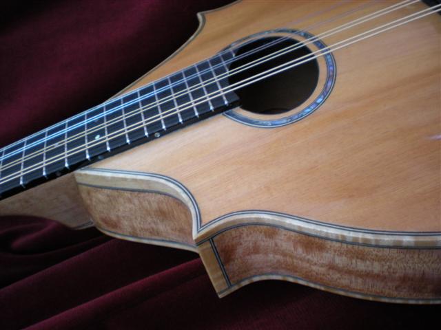

Post by Clancy » Thu Apr 09, 2009 3:39 pm
Thanks everyone.

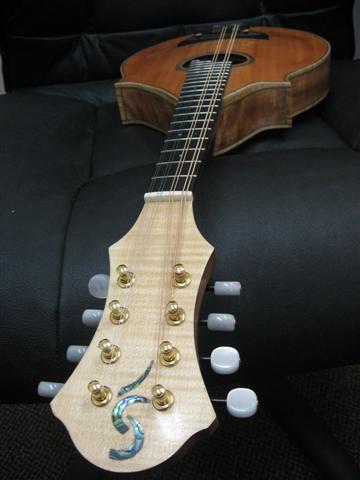

Got home early so here's some pics from other angles.
Steve, believe everything you hear about Queensland Maple.
It's a joy to carve, sand and scrape.

Beautiful Mandolin Craig.The maple looks great as always.It is literally one of the best cabinet timbers in the world and as you say it carves and planes to a lovely finish,If needed it will also take stain very well.Ages to a better look as well.Cheers.

That is a beautiful instrument Craig. It is hard to believe that it is your first mandolin.
