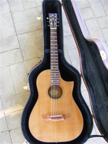

Finished at last, I could write a book about this build but it would be too depressing to recall the event.
Little mistakes and accidents took all the joy out of this project from about mid way through and through the finishing stage. In fact I strung it up as soon as I could to hear what it sounded like as I was thinking of scraping it, but it sounded good enough to keep me going. And now it is finished, and the name I gave it is “Mysteryâ€

Allen, the case is a cheepy $120.00. I bought it retail from the shop where I meet my customers as a bit of a payback to the owner. Its far too big, but I like to reline the insides with extra padding for more protection.
Its got UXL on a gold plate on the out side.
A bit sloppy at the moment.

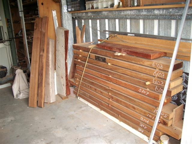

Hi Stephen, I'm not real well versed in timber but I did feel this NGR was worth persevering with, so I bought up a lot over the years. If you buy it as "tonewood" its dearer than "timber on the rack" at the local yard.
All on the 1/4. Takes some digging to get that.

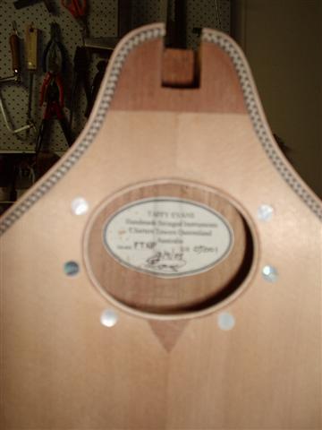

Hi Cactus, I made the Rosette out of herringbone purfling as used in the mandolin above

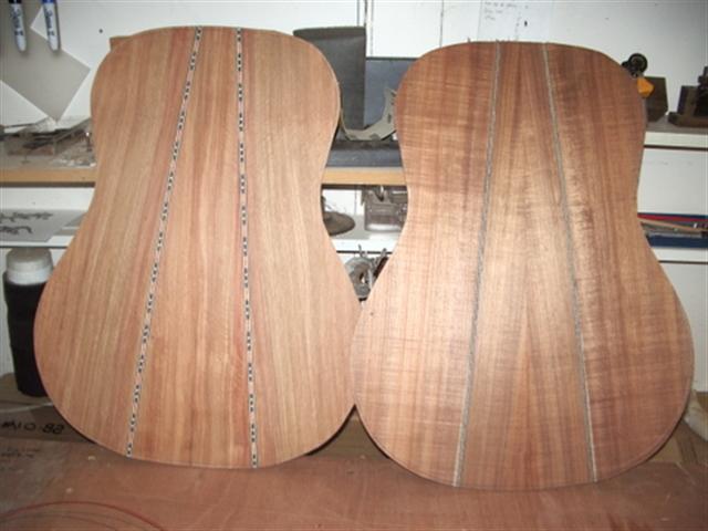

Stephen, I used to use this timber for experimental instruments and first time projects, but It's moved up my list of prefered wood. I've got a small parlor guitar [smaller than the one above] a dread and a "000" on the go at the moment. I'm building two identical guitars one is NGR and a Blackwood, see photo of the Dread models backs.
