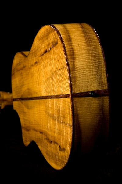

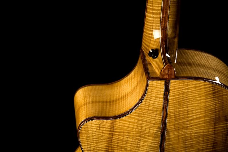

Oregon Myrtle is a joy to work, and it's not too hard on the eyes, either.
Bends easily, sands easily, glues just fine and it can be obtained in quite curly pieces.

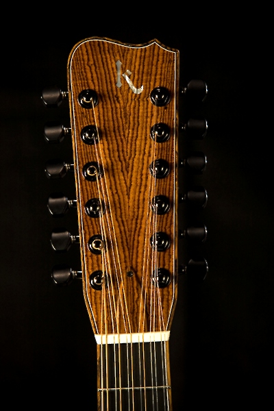

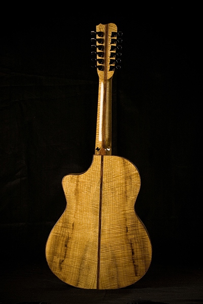

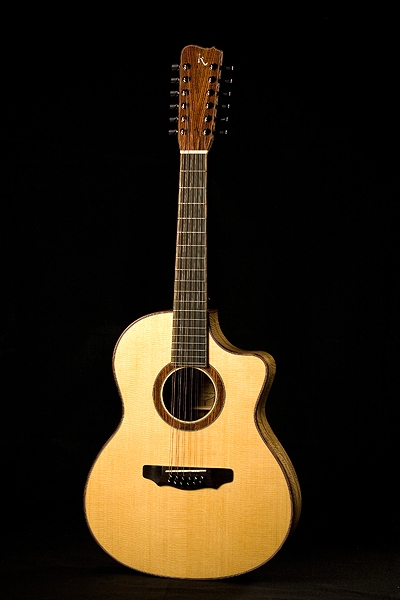

This guitar is for a friend who wanted another 12 string, who realized he always played a 12 with his capo at the 2nd fret. Why not just whack off those first two frets? Put the nut where the second fret would be, and make the scale length that much shorter? Oh yes, and tune it up to F#, instead of the usual E. Put all that on a smaller body, and you've got what he calls his 7/8-size 12 string. The short neck w/ long head makes for a different look from the rear of the instrument, but I like it. What's exciting is tuning that high octave g string to an a. Run for cover....
The specs: Top is Lutz spruce from Shane,
Back/sides: Oregon Myrtle from Bruce Creps.
Neck: Oregon Myrtle and Bocote.
Bindings, peghead, rosette: Bocote
Fretboard: ebony
Bridge: African blackwood

Thanks for clearing up a problem I had too, I have a myrtle B&S set light in colour like these & I couldn't make up my mind what to use as a contrast binding with them......problem solved.

That short neck and long head stock just looks killer. Almost 1/2 of each from the back. I really like that look for some reason.
Oh, the woods not too hard to look at either. 8)
With a neck that much shorter, but tuned up, does the string tension work out the same?

Very nice as usual. It's fun doing "interesting" instruments. It looks a little like the South American multi-course instruments with the short neck - cuatro etc.

Steve, this is just beautiful! I'm curious if you had ever seen Bocote binding against Myrtle, because it is such a perfect combination.
The neck - oh my god the neck! - ties it all together so well.
Have you calculated the total amount of tension on this instrument? I'm thinking I'd use ultra-light strings to keep the tension closer to 200 than 300 pounds.

Lillian , I say go for the Myrtle . Easy to bend and a dream to work.There are some pores to fill but very little.

Allen, that's the theory. At the 2006 GAL convention we kicked that idea around w/ as many folks as we could. Ervin Somogyi was of the feeling that it would be a wash.
Dennis, this is my second guitar w/ Bocote used against Oregon Myrtle.
I was somewhat stumped by the greenish cast of the Myrtle, but Bocote matched it, and that convinced me to use it again.
Tension--no, we haven't tried to work that out. And yes, those are ultra-light gauge strings. The treble "ee's" are 9's.

Ain't no moss growin on that boy. Beautiful, Steve. The match between the neck and back is just incredible. (If I may, Hesh) :cl :cl :cl :cl :cl

P.S.--Dave W, I agree, it does have a South American vibe about it.
