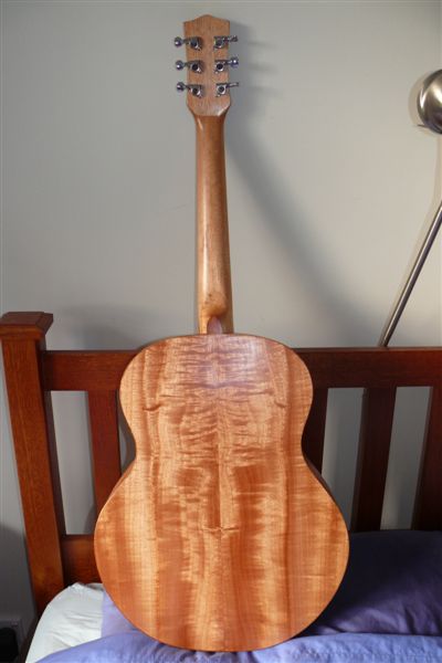

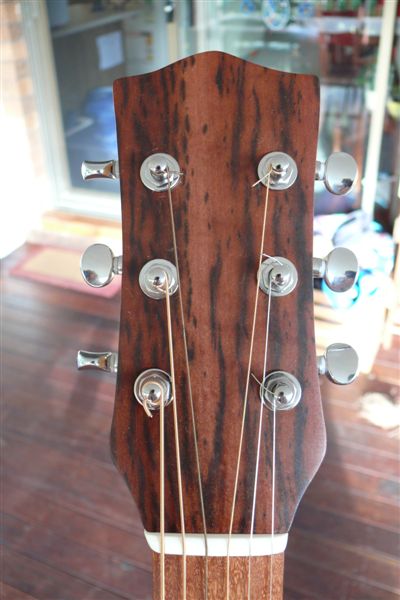

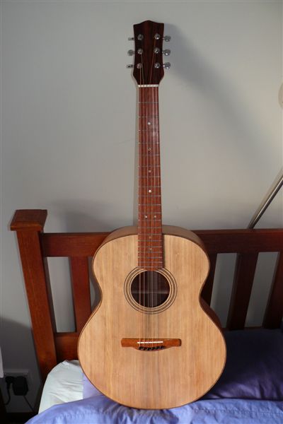

I have been reading your forum for a while now & have really benefited from your collection of information. I haven't got any tricks or tips that I can share with you all, but in the spirit of this sort of community, I do have some pictures of wood.
I completed my first guitar late last year. It sounds nice, but isn't that pretty - I have noticed that you haven't run a tutorial on how to scorch & crack sides yet - happy to help out :lol:
Here's some pics of the steel string I have just finished. It's more of a collection of wood that I liked the look of, rather than a lesson in aesthetics, but perhaps that will come with time. A nice piece of Tiger Myrtle from Tim S,
bunya soundboard, Cooktown Ironwood fretboard/bridge.
Qld maple back, sides & neck
It doesn't sound as bass-y as I thought that it might, but I guess that I didn't really know what to expect. Anyway, I've learnt heaps of things for the next project.

Good job on the guitar, looks nice and tidy & well executed. I presume the pictures are of the first one that you talk of? Doesn't look like the ugly sister to me! :)
Must confess to not liking Tiger Myrtyle much (:shock: *ducks to avoid rotten fruit from other members*) but the Bunya looks really cool & a gorgeous bit of Q maple too!

Your first axe looks pretty good to me, mine looked good in pics, but I see all the errors, just like everyone else does with their first, I guess (except Craig who got pics of his first in the bloody LMII catalog). If you aren't happy with it, build another, and another, and another. Just like the rest of us.
Oh, and I'm not too keen on tiger myrtle either Nick, though I used it for bindings once.
What plan did you build from? Looks like an OLF SJ or MJ.

Nice looking guitar. That Maple is pretty, Im going to have to get some of that. Most importantly you like the sound, you can always call it a "studio model" :lol:

Welcome to the ANZLF. I really like your first, from the images it shows a tasteful blend of woods and well executed build.
How thick did you leave the Bunya??

Thanks for the welcome everyone. No, these picture were of the second guitar that I just finished (the first one is a classical with a kauri soundboard). For both guitars I just worked through Jim Williams' book. For the steel string I followed Jim's basic procedures, but changed the shape to something like the SJ (so Kim, the bunya was 3.2mm).
This one turned out way better than the first, and hopefully won't be as good as the next one. It is remarkably easy to spend large wads of cash on wood, but what a satisfying way to spend your time.

Hello Steve , Welcome to the loony bin.Your guitar looks great and I would say that with the top that thick it might take a little while to "open up" and show its true sound.Play it often and I am sure it will settle in nicely.

Your guitar looks fantastic and I like the Myrtle headplate. Very classy indeed!!

Cold and 'wet' sounds like a understatement at the moment. Nice bit of Australian tree you have there Steve and that is a particularly tan looking bridge that sits well in the middle of that bunya pine, nice work.
