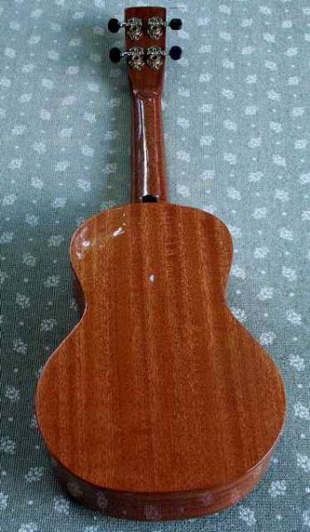

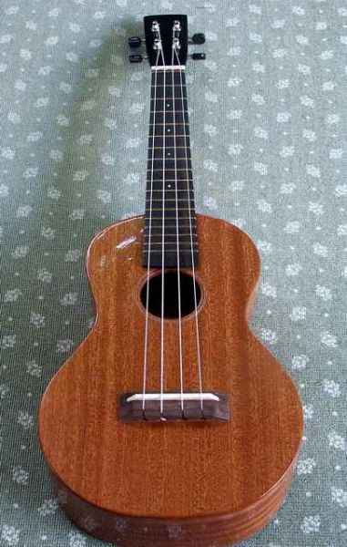

This is a huge departure from the last guitar I built. This uke was a semi timed build with another having parts and assembly done in unison, or in the case of rim assembly, one after the other. I was trying to get an idea of how long something really plain would take to build, and the other has just some plain bindings added. It's still in the spraying stage, so is a few weeks away from being strung up.
The body is a guitar set that makes 2 Concert Size Ukes. Sapele from Uncle Bob.
Neck is some undetermined local hardwood. Much like Mahogony in it's working proporties.
Ebony Fret Board is one of Uncle Bob's that I resawed into 4 Uke fret boards. Good value in that.
Fret wire is Gold EVO
Finish is Miratone 3220

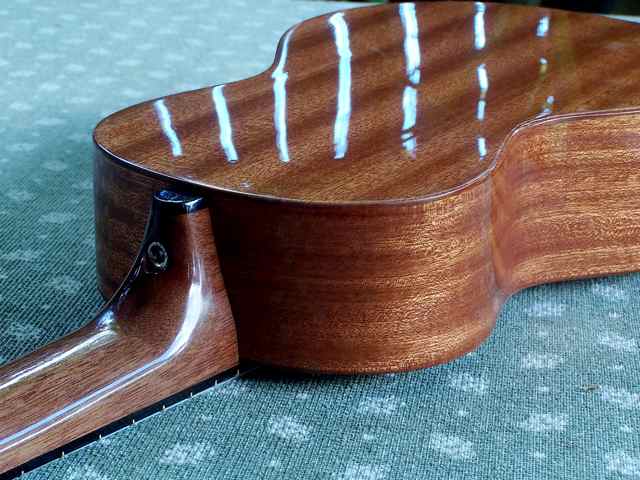

Bolt on neck from the outside, because my hands are just too big to do it from the inside.

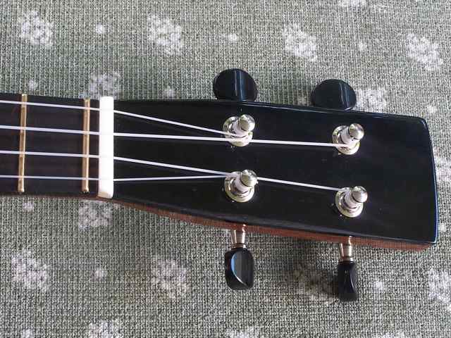

Tried out a zero fret on this instrument after talking with David Hurd about how he sets his ukes up. It does make for easy set up of the action at the first fret.

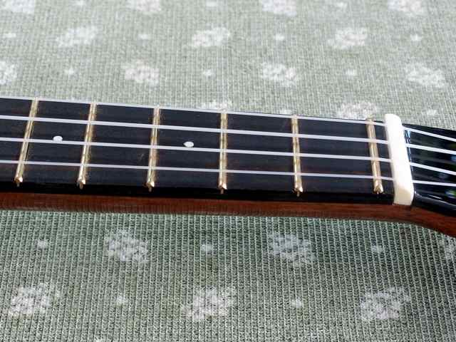

My take on semi hemispherical frets. Level, bevel, round over and buff.

I'd say that the zero fret is quicker. By how much....well it really depends on how good you are at set up.
I use the regular mandolin - uke wire for the frets, and some heavy guitar wire for the zero fret. Setting the action was pretty simple. I set my straight edge on the zero fret. A spacer of desired thickness on the 12th fret, and drew a line on the saddle. Strung it up, and action was bang on. As it settles in I may have to go back and tweak it for the 12th fret relief, but this was really quick and simple.

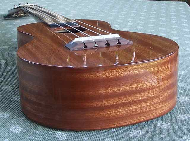

Still only been strung up for 8 hours, and these nylon strings take forever to settle down. I made the top 1.5 mm thick in the bridge area, and down to about 1.2 - 1.3 in the lower bout perimeter.
Bridge patch and 2 finger braces as per the plan. The finger braces got shaved down a lot. I hear again and again to build ukes light, so this one certainly is.

Allen , I got stuck into the braces on a baritone top yesterday and it loosened up nicely with not much wood left on the fan braces.I think it shows the plans are way overbuilt.

Thanks also for trying the zero fret. I'm glad that it worked out for you. That trick of putting the action spacer on the 12th fret and using a straightedge to determine saddle height is a great one. So easy...

Aside from easier set up, having experienced the problem of strings wearing down into the nut slots requiring repair or replacement of the nut, the benefits of a zero fret becomes even more tempting to adopt into acoustic guitar construction.

After installing the zero fret, I'm not sure why we don't see more of them? I don't think that it looks odd, but maybe others do, and just don't like them.It also take a most of the fiddly work on the nut out of the equation.
Stu
Posts: 245
Post by Stu » Mon Mar 30, 2009 6:48 pm
That's sensational Allen. :D
True about the lack of zero fret instruments around.
For me the difference and I guess the element I'm grappling with is the
difference you hear in an open note or chord with a conventional nut compared to a zero nut.
In reality, a struck open chord with a conventional nut will always sound different to a fully fretted chord so I guess the zero fret rids us of that discrepancy.

Did it take long to do the semi-hemispheric frets on this one compared to
usual techniques? Very nice.
Cheers, Stu
Post by Allen » Mon Mar 30, 2009 7:00 pm
What is the usual technique? I've never been able to determine what it is that people are doing to get them to look like that.
I once tried to make them the exact size with the ends done and then press in, but that was really unsatisfactory, as I found it impossible to get all the frets to be spot on in length. Perhaps I'm just a bit slow, and don't understand the technique.
All I did here was to press the frets in over length, nip and then file flush. Bevel at about 30 degrees, then use a flat needle file with a safe edge and just roll over the ends.

Usual technique meaning 30 degree bevel without the semi-hemispheric rounding.
I've been reading a bit about it on this forum and it still looks like alot of work. Nevertheless it's very impressive and I'm keen to try..
