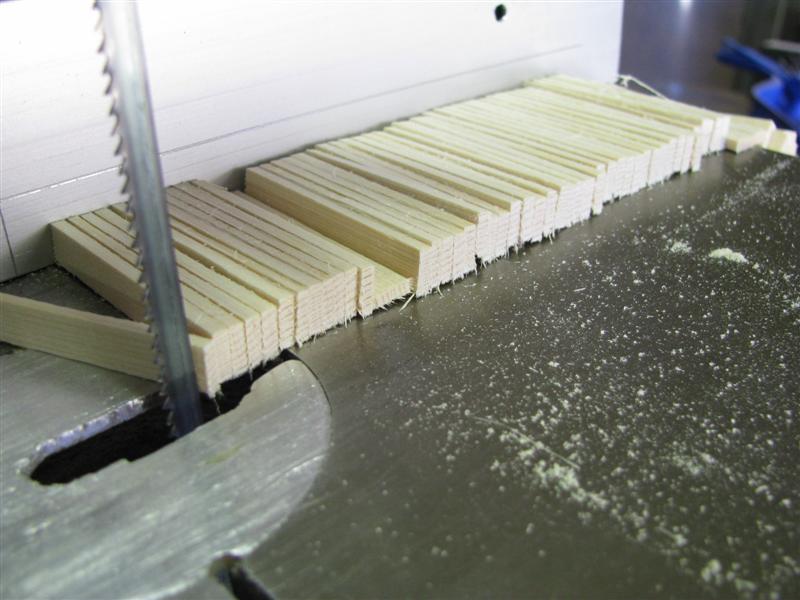

I got stuck in over the last few days and mass produced braces for the next 20 or 30 guitars.
I still have to do the lap joints on the X-braces and radius the X's as well as the back braces
Once done, however, it should make assembly much quicker.
Bear in mind that these are not the final dimensions of the braces, but they will certainly save a lot of time as I know that I wll take them down at least this far with a chisel.
8mm x 2mm X-brace cappings (did some 6mm as well)

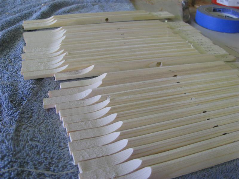

Tone bars - one end scalloped so that they are usable on all guitar sizes

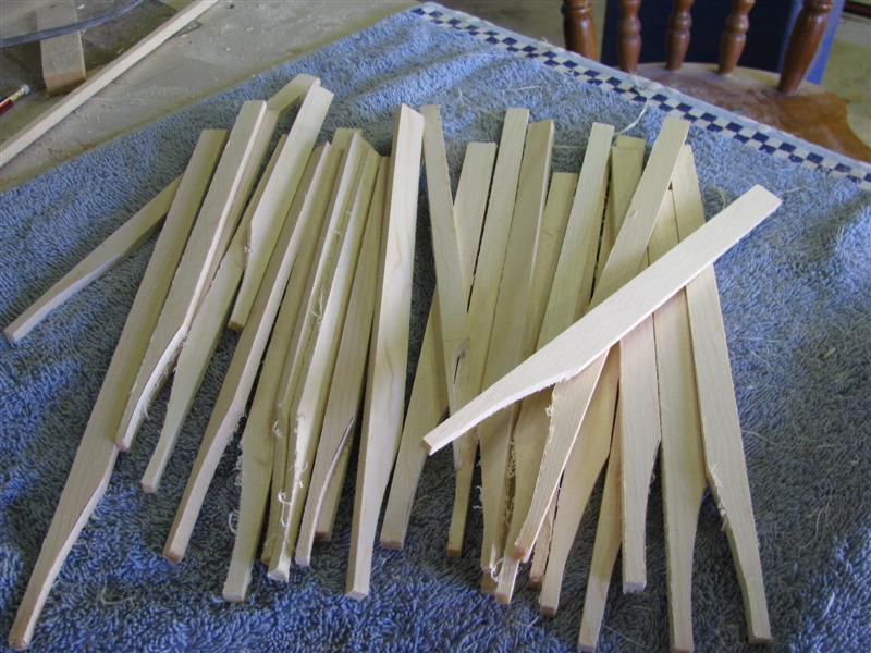

Finger braces - (Dreadnought/jumbo size that can be quickly re-sized to fit anything)
