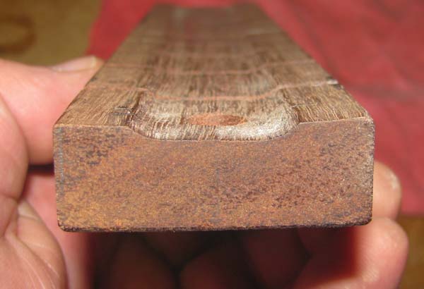

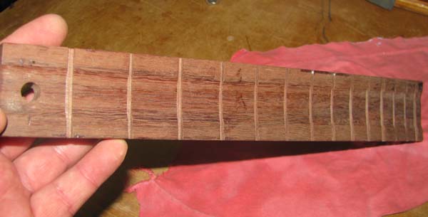

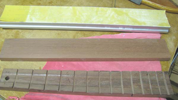

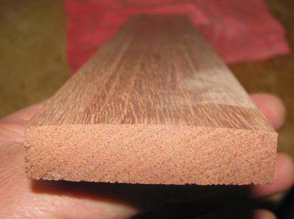

As mentioned I fret the board off the neck. The gluing cauls are not overly complicated to make. I used my fretboard radius jig to cut the desired radius onto a 20mm bit of jarrah (a hand plane could be used here) and then sanded this with a Stewmac sanding beam with matching radius to make sure it was smooth. I then fitted a strip of PSA abrasive from the sanding beam to the surface of this newly shaped board.
Taking another piece of jarrah I will use for the caul, I tapper it to roughly match the fretboard and run it over a router table spinning a tray, or dish cutter bit removing material from the centre of the board. This is so the finished caul will only be applying pressure to the outer 12mm or so along the sides of the fretboard. Doing so allows for an invisible joint along the edges yet ensures enough epoxy is left under the centre of the board to avoid a staved joint.
I take this piece and using the first piece of jarrah I shaped as a 'reverse' sanding beams, I sand the desired radius into the outer edges. So that the caul will clear the frets, I mark their location on the caul with a pencil and run shallow cuts across the caul with the table saw.
Here's all the bits,
This is the fist bit of jarrah showing the radius, I will use this as a reverse radius sanding beam.
Here is the caul all done with the radius shaped into the edges, and the next shot showing the fret clearance slots.
