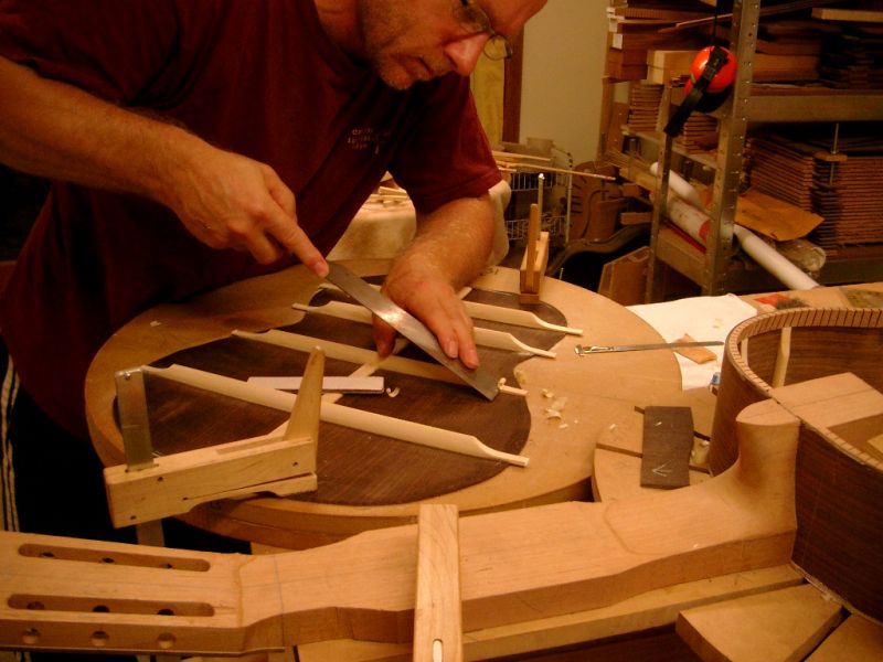

Okay today I finally managed to get in some quality time in the workshop. Currently working on a classical for a friend in Sydney. In the pic Im working back braces with my trusty Sorby 3/4" paring chisel.
Cheers Martin

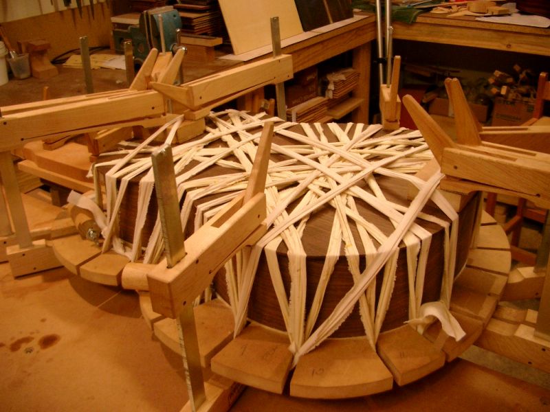

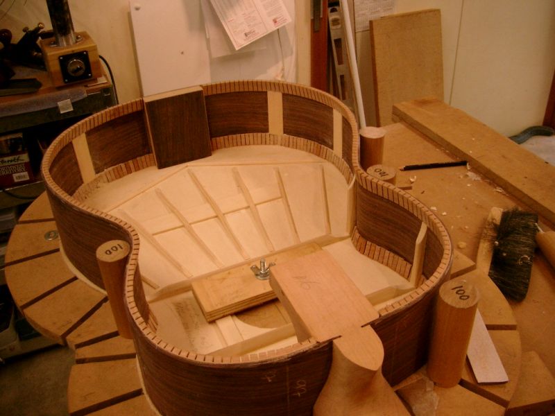

A couple more pics. Pic 1 showing top bracing....standard Torres fan bracing. Pic 2 is of the back glued on and roped up. The butt block is an offcut from the headstock (IRW venerred mahogany)

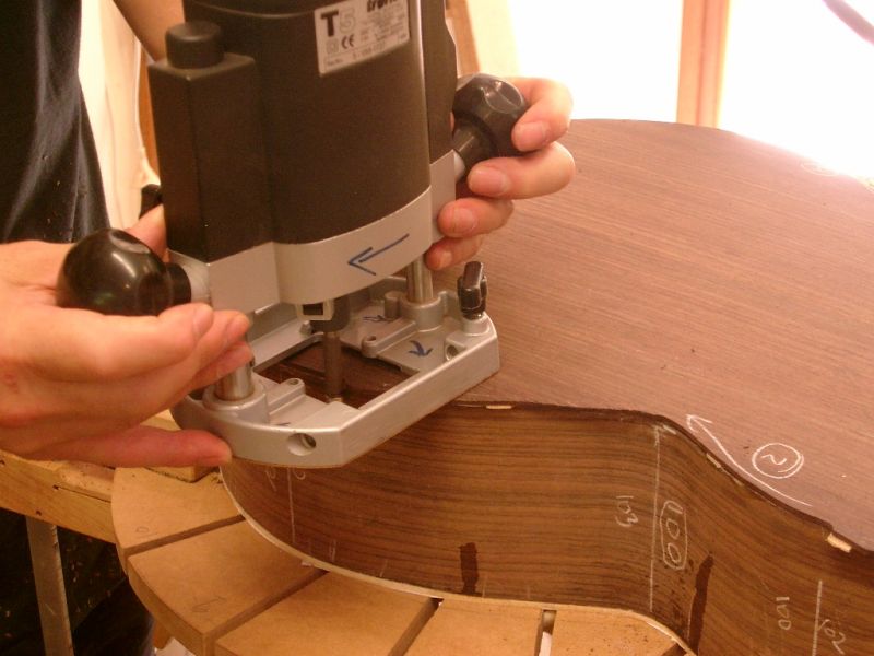

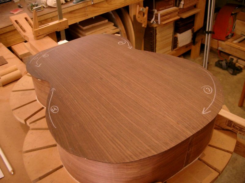

Ropes off and a quick run around with the bearing twin flute flush cutter to trim the back overhang. I always draw sequence and direction of cuts on the back before I start. The router is my trusty Trend T5....its about the only decent thing coming out of the UK these days apart from Colin S and Dave White's guitars. And yes Im being naughty and Im pulling the router towards me...had to do this so as not to obscure the shot with my fat body.

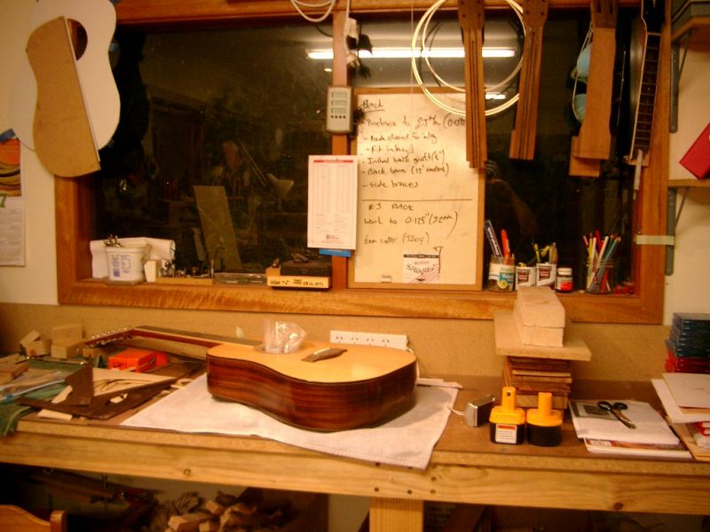

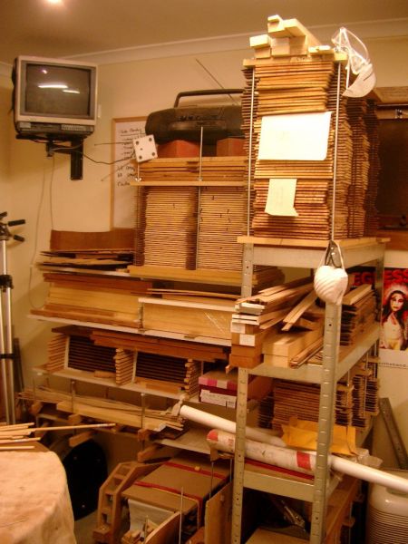

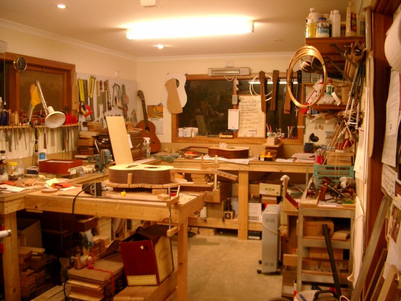

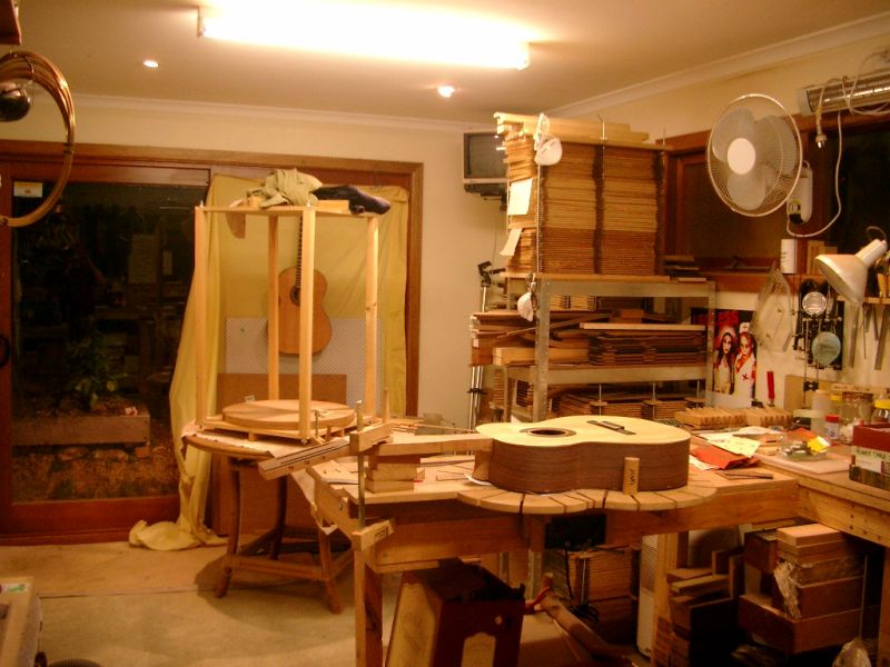

A pictorial guided tour of the shop attached.
View of the shop from main entrance.
View looking towards main entrance. During the day theres a view out to the vege garden. On the wall is the trouble classical. Every few months I take it down and work on it and a few weeks later I get p****d of with it and it gets banished back to the wall. One day it might get finished.
The window looking out to the street below....I spend a fair bit of time sitting here staring out the window watching the world go by and thinking about things....occasionally my thoughts are on guitars....more often my thoughts are on noting down rego numbers of passing hoons and dropping them down to the local boys in blue.
Unprocessed pile of side wood thats been sitting there for 18 months. Gotta find somewhere to store the stuff. The guitar in the corner is my favourite instrument a K Yairi flamenco thats over 30 years old. Its waiting on a re-fret and new saddle.

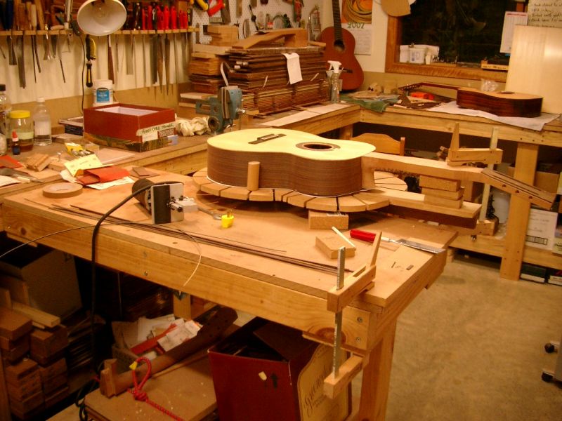

Current project..."Ruby's Classical". Waiting on bindings and purflings from Stewmac.
Part of the wood stash and the TV.
The island bench where most of the action happens. On the bench is a Porter Cable 310 trimmer with a Luthier Tools binding jig attached. Its a quality jig but takes a bit of skill to use properly Image

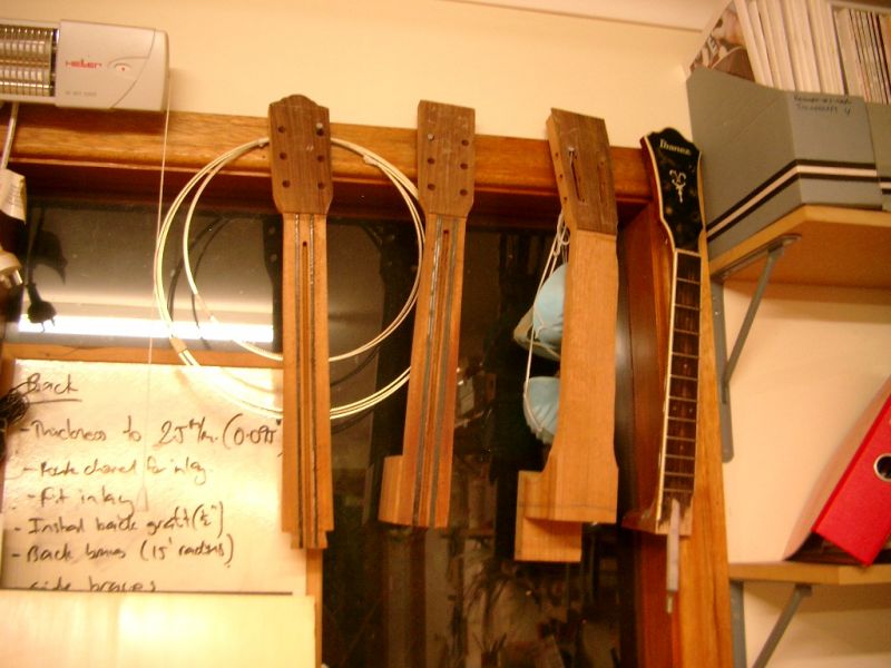

The wall of shame......an array of stuffed up necks. The best way to avoid repeating mistakes is to have them on display so you can see them every day.

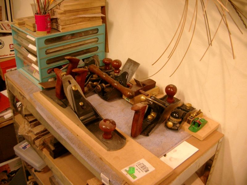

And the fleet of planes....mainly Veritas planes. Theres also an HNT Gordon in there which hasnt been used yet. The favourites are the low angle blockie and the No 5 smoother. The Miller Falls scraper plane also gets alot of use.
