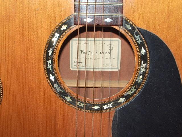

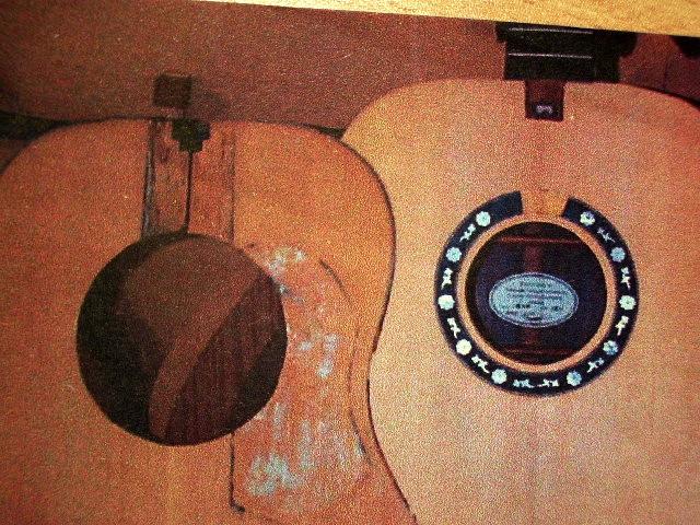

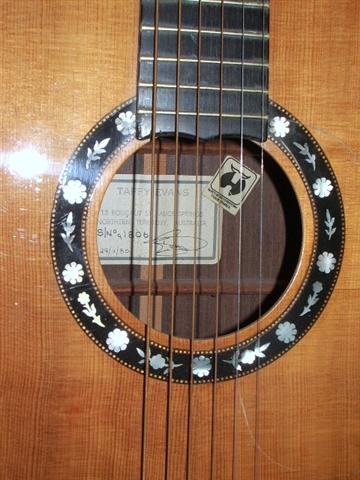

I did something similar on my first couple of guitars back in 1977/80. I used epoxy [Araldite] dyed black and pearl inlays. The photo's are of #1 and #3. And a major rebuild [flood damage] where I took the rosette out and put it in a new top.
