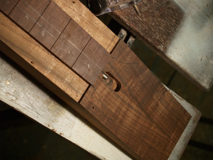

Here's my latest project. A double cutaway using Qld walnut for the body and neck, figured Tassie Oak top and a Gidgee f/b and headstock veneer.

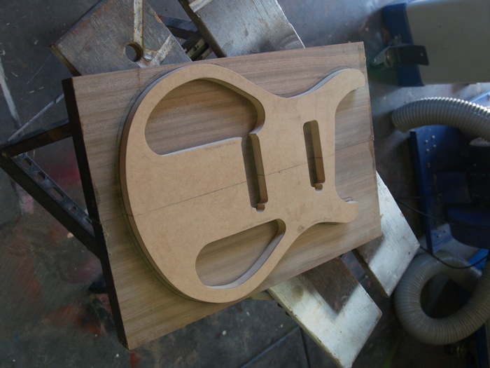

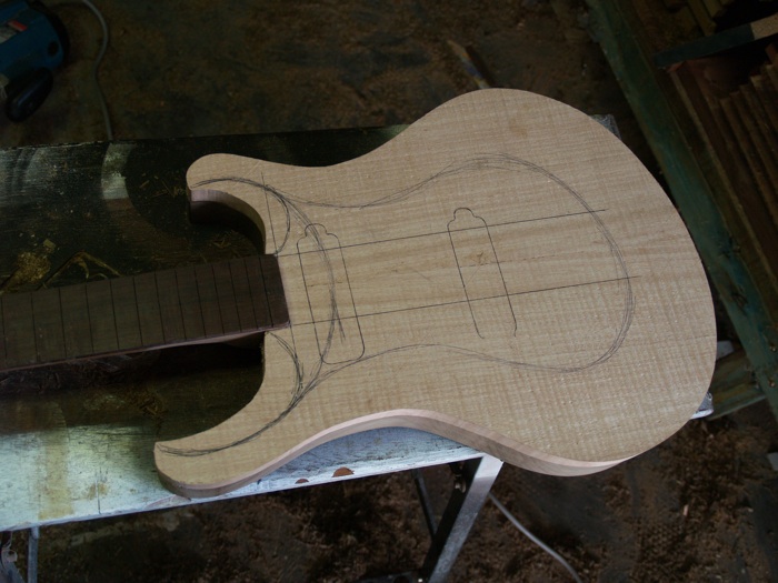

Ok, here's a sneak peak of the body and template. Got something cool planned for the pickups, but we'll get to that later.
Just a few pics to show the progress of the neck.

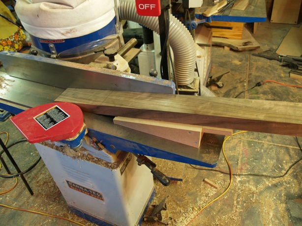

This is a jig I made to get my 10 degree neck angle, I rough cut the angle on the band saw, and then follow it with a few passes on the jointer.

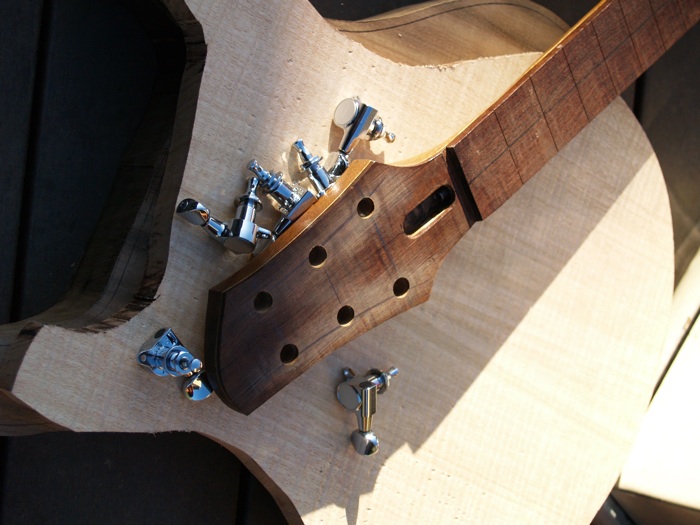

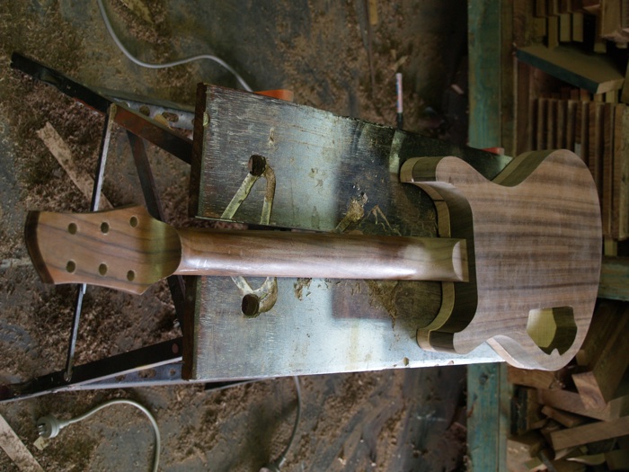

I then glue on the headstock veneer and fretboard.

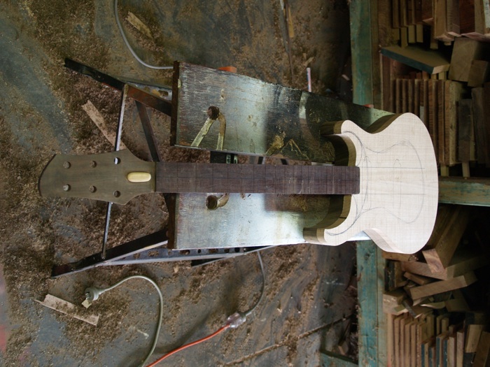

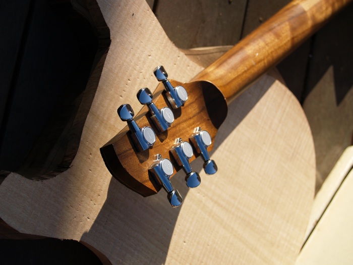

And this is where I am now.
Ill post more pics soon,
Deano

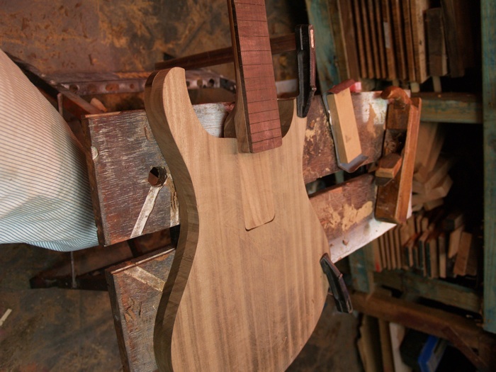

Here's the latest progress. Got the neck pocket, 'inside' pickup cavity's and tone chamber routed.
