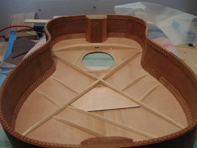

I have been making a mess in the shop, but I think I've been making progress as well. The top is as done as I'm going to get it, I believe. Its been an interesting experience. Clean and neat isn't as easy as I thought it was going to be. Fish glue is a bear to clean up if you let it dry. This may end up as kindling, but I will have learned from it.
I need to add some tape to the side for insurance, but they are basically done as well.
I guess its time for me to start work on my binding jig.

Looking good Lillian. Nice tidy work.

Looks good to me too.
Though, I'd could say it was a little over braced, I could, but I won't. 'cause my first looked pretty much the same as far as bracing, and it sounds fabulous. I'm sure yours will too.

About the side reinforcements: I like to have them span the whole height of the sides, not just the distance between the linings for fear of creating a weak point between the two. With side tapes, I believe most builders just glue the linings right over them (I use thin wooden slats, Benedetto style), and that is easier to before the linings are glue in.

Thanks Arnt. As for the side reinforcements, that is what I intended to do, but was distracted/excited about actually building that I skipped right over putting the side tapes on first. Issues abound.

I think that your bracing looks fine and your workmanship is excellent too. What brother Arnt said about the side supports but I will add that some builders that we know don't use any side supports what-so-ever. I still would use them though.

That's looking great Lillian. I'm sure it'll sound fine and I reckon you'll surprise yourself when you hear it strung up.

I agree, I don't think you'll be displeased at all with the sound. It doesn't look overbraced to me. The bridge plate does look a little bit big though. You could take 1/4" off the top and bottom edge of it I think and you'd be just fine.

Ron, the bridge plate is off of a plan set out of Kinkead's book. It's thicker than it should be by about a half a mm. I've gone back in a thinned it a bit more since the picture was taken. Thanks for the critique and support.

Lillian, that brace carving job looks outstanding to me. I believe you are gong to have a great sounding guitar. Nice work.

The back is done. I just need to sand the braces back a bit to clean up the plane marks.
I may go back and look at the top again. I'm thinking about uncoupling the finger and tone braces from the X brace. The top is super stiff, no defection to speak of really. I know that the bridge plate has a lot to do with that and I'm going to try to thin it out a bit more. I laminated rosewood and maple in the 28' dish. I should have gone thinner with the laminations. I believe that it is stiffer than expected because it was laminated and glued into an arch. We'll see. I'd rather not use mediums on a guitar that I intend to learn how to play on.
