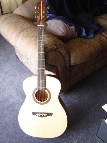

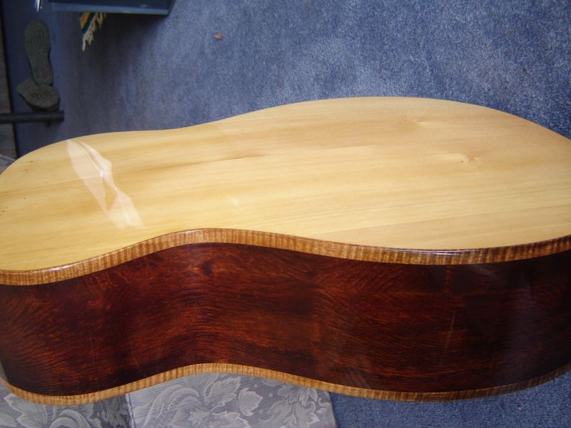

Post by Dominic » Sat Feb 21, 2009 7:16 pm
Hey, I have put up a few pics of this guitar at various stages and it is finally finished. It is for a mate made mostly of wood a he has been collecting and saving over the years. The sides are native pear with a figured mahogany veneer inside to help keep it together. The sides are book matched to make up the width. The back is 4 piece Huon pine. The neck is WA marri and jarrah. The bindings are the same curly marri as the neck. And the rosette is jarrah burl.
It has challenged me at ever step but it has turned out pretty good
I am very impressed with the sound. It is a level above my other guitars.

Post by kiwigeo » Sat Feb 21, 2009 9:22 pm

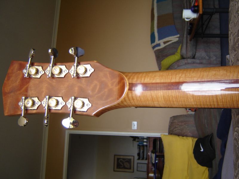

Nice piece of work there Dom. A rather unusual collection of woods but it goes together well. I love the "odd one out" black bridge pin and the tuners.

Post by Mark McLean » Sun Feb 22, 2009 6:05 am
Very individual with the unconventional mix of timbers. I love the idea of using materials that have been scrounged and found. Beautiful neck. It looks deeper than the average OM - how does that affect the sound?

Post by Dominic » Sun Feb 22, 2009 10:24 am
Hey, Thanks everyone.
Martin, I lost a white pin somewhere and had to make do with one dark one. I'll fix that up before I send it home. The tuners are the grover copies of the waverly open back ones. I like them.
Kim, the pear is quite soft but it bent in my fox bender with out problems and was very easy to work. It is just stunning with a finish. Smells nice too. I've got a bit more but not enough for a guitar. The veneer I backed it up with is the same as on the back of the headstock. It made very stiff sides.
I also have enough Huon left to make a full B&S set.
Thanks Hesh, i used my new festool sander and got a great finish for buffing with no hand or wet sanding. I used the platin disks.
Mark, the neck is a little deeper and a little wider than usual but the new owner has big hands and the cury marri was a little bendy so I wanted to leave as much meat as I could. It is also full of CF rods. But it is very comfortable to play.

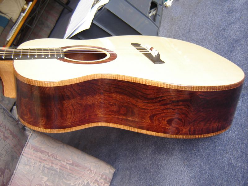

Post by Dominic » Thu Feb 26, 2009 8:28 pm
Hey Hip, the sides are 2 bookmatched pieces each. You can see where I edge glued them. I used epoxy to do that before bending. The epoxy let go in a few places and the pear is quite soft which led me to use the veneer to add a bit of stiffness.
I just glued up the bent sides and taped the veneer in place then put it back in the bending mold to set. Worked great. I use turn buckles on the ends of the slats on my bender so I can crank it down tight and get out all the air.

Post by matthew » Thu Feb 26, 2009 10:42 pm
I'm sorry I don't quite get that, nor see it. You say the sides are made of two pieces bookmatched - how? I can't see that, on either shot of the ribs, at all. Got any clearer shots?
And you use epoxy to edge-glue the sides before bending? I ask because I'm faced with this sort of thing all the time with my blasted 10" ribs ... I've wondered how to achieve multi-piece ribs.

Post by Hippety Hop » Thu Feb 26, 2009 11:09 pm
I can see the joins. About 20mm from the back on the lower bout to about 10mm on the upper bout.
Don't quite understand the gluing procedure, but if you clamped them down in the side bender I kinda get the picture. Thanks.

Post by Dominic » Fri Feb 27, 2009 10:13 pm
Yep, Hip sees it. If you look in the pic that shows the Huon pine back you can see where the pattern repeats about a ¼ way down from the back. I should really have run the join down the middle of eachy side.
The gluing procedure went like this.
I matched the 4 bits for the 2 sides. Jointed up the edges then glued them up with epoxy. That gave me 2 pieces big enough for sides.
Then I profiled and bent them. I was hoping the epoxy would hold but it came apart in few places. But the glue line remained very clean. So I reglued the 2 pieces of each side at the same time as I glued on the inner veneer them carefully put it back in the bending form.
Once I filled the pores with Zpoxy it came out very smooth.
