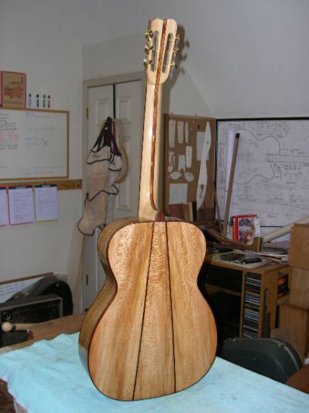

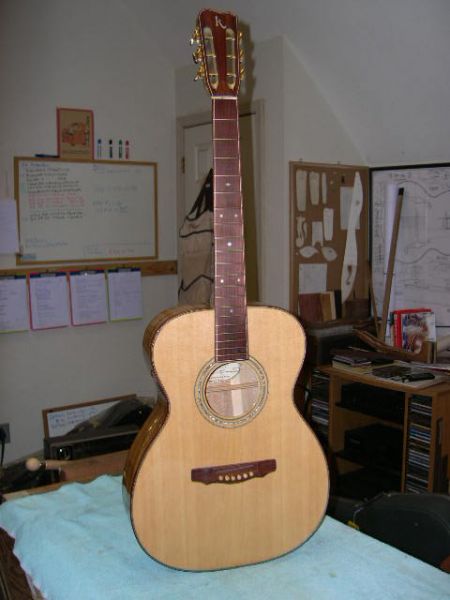

G'day mates, here's a shot or two of one almost finished.
The back/sides/neck are American Sycamore.
Top is Sitka spruce.
Bindings and center lam in neck are Bubinga.
Fretboard, peghead and bridge are Texas ebony.
Thanks for looking!
Cheers, Steve

That looks beautiful Stephen.The colors are great together and the little line around the headstock is very classy.What plan and scale length did you use?

Michael, the scale length is the normal Martin long scale, 25.4". As for the plan, I measured & traced a pre-war Martin that came through our shop, then devised my own bracing pattern based on the Martin "X" brace system.

Those bindings sure look good against the body. I'm assuming "Texas Ebony" is a local name for some overly hard wood like out Cooktown Ironwood, aka "Red Ebony". Is it easy to come by. Looks very good as well.

Pithecellobium flexicaule is the scientific name for Texas ebony.
Also, P. ebano. So no, it isn't an ebony, but like you said an "overly hard wood". Supposed to be murder on chainsaws.
The small yard that carries this species gets only little pieces now and then. Otherwise, it's not readily seen commercially, even in Texas.
The board from which these pieces came was black as coal.
A little sawing/planing revealed it's red interior.

Understated appointments with outrageous timber, well done! I assume the three piece back was a necessity?

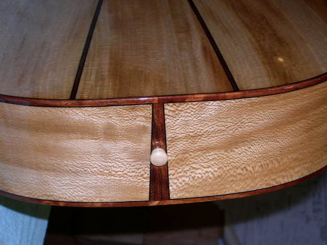

The binding is such a beautiful contrast against the sycamore. The whole guitar is absolutely first class as usual.

Alan, Bob, Sebastiaan, thanks mates. Yes, that Sycamore board was only 5 1/2" wide. (Don't know what that reads in mm.) But it was too pretty to pass up. Plus, I happen to like 3 piece backs, so it was right up my alley.

Gotta love that sycamore. Did you do a three piece back by choice? I think 3 and 4 piece backs can look stunning.

Larry, glad to bring you out of hiding. Yes, the 3-piece back was by choice...in that I chose this board that was too narrow for a 2-piece.
It was just too pretty to pass by, so also by necessity the 3-piece back came to be.

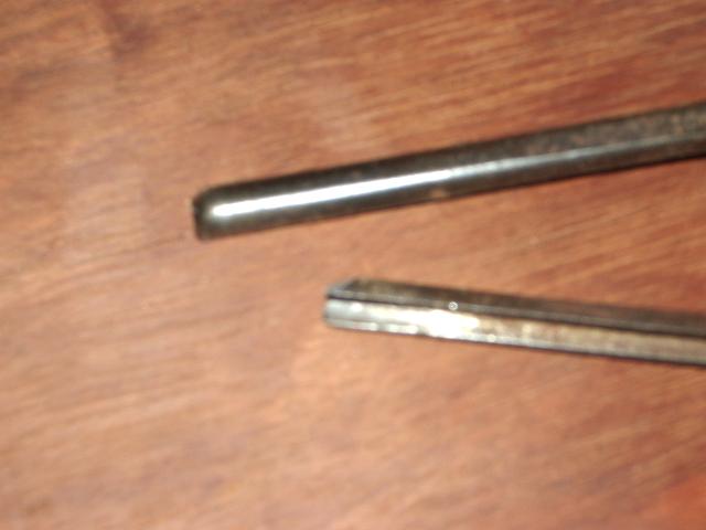

I was allotted the task as being the only person [at that time] allowed to repair or reproduce replicas of the original cases; these were copied down to the last detail, even using silver hinges and catches. All the cases no matter what the size had the same features. One of which was a flute around the top edge of the case. This picture of an early guitar I built may have been influenced by this and shows what I mean. Also shown is a picture of the gouges I used to make the flute in the cases, the one in the guitar was routed.
