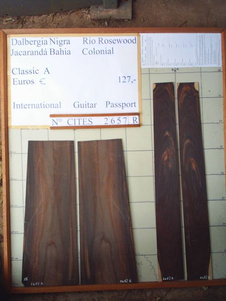

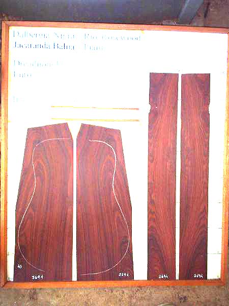

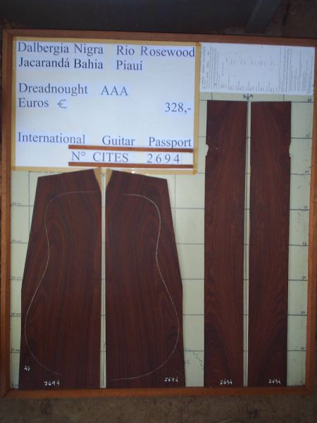

The pics below are the sets he picked out, price is an issue so I’m leaning towards the budget set but was wondering what you guys and gals thought. The cheaper set has a few worm holes that would need to be filled, I’m wondering if that is enough of a detraction to justify spending his hard saved cash on the better set. The price is in the photos, double it for Australian dollars.

That A grade set seems too cheap for BRW. Warning bells! You get what you pay for. If your mate has the $$$ and is prepared to part with them maybe the higher priced set would be the way to go. Hand built in BRW - a few hundred dollars extra hardly seems an issue.
Post by Bob Connor » Sun Feb 08, 2009 6:06 pm
That cheap set is slab sawn so I wouldn't touch it with a barge pole.
Can't really see the second set in the photo but it looks like some of the really dark quartersawn stuff like I have.
Bear in mind that if you do build this bloke his dream Brazilian guitar that you'll be probably be repairing cracks that will inexplicably appear at some stage down the track.
There's good reason that a premium of up to $2000 USD is tacked on to Brazilian Rosewood instruments. It's not the cost of the wood. It's the warranty work down the track.
Braz is notoriosly unstable.

All true words Bob and after photo shopping the second set I can see that it too is slab cut stump wood. The short grain in the back set looks to be a bit of a worry, especially at the waist area and mid lower bout and the sides look down right scary. Just my opinion but I would not buy any of this wood.

Both sets are VERY inexpensive by US standards and what we have here does not have CITES paperwork which is said here to add greatly to the price/cost.
It's nearly impossible to find BRW here that is not slab sawn without paying $1,200 or up......
