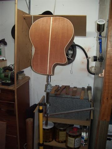

I’ve got too much time on my hands due to the constant rain so here’s another gadget from the recycle drawer.

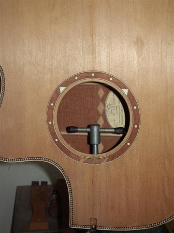

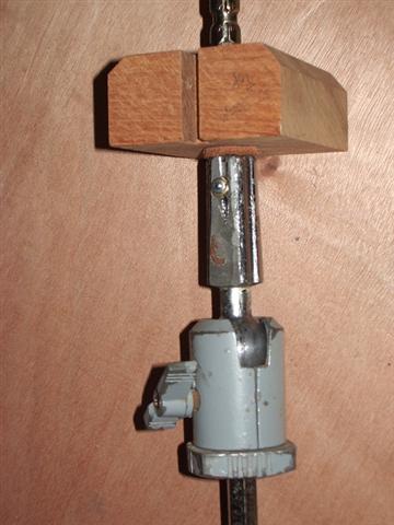

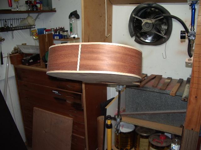

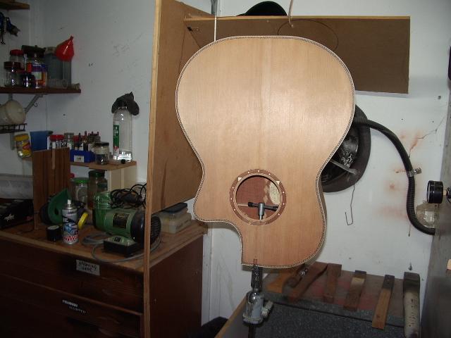

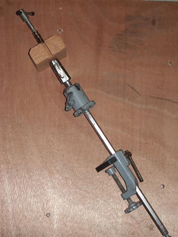

I hope the photos will tell the story. This devise allows for the guitar to be locked at any angle very quickly for spraying different sides. I bought it in a junk shop not knowing what to use it for, all I knew was that it had a use and has had quite a few over the time I have had it. It’s mounted to a flood light tripod so can be moved out side for spraying in natures own spray area, or in my small inside spray area, and it folds away for easy storage. Of course after the body is secured, the soundhole of plugged in the normal way.

Nice rosette Taffy.
