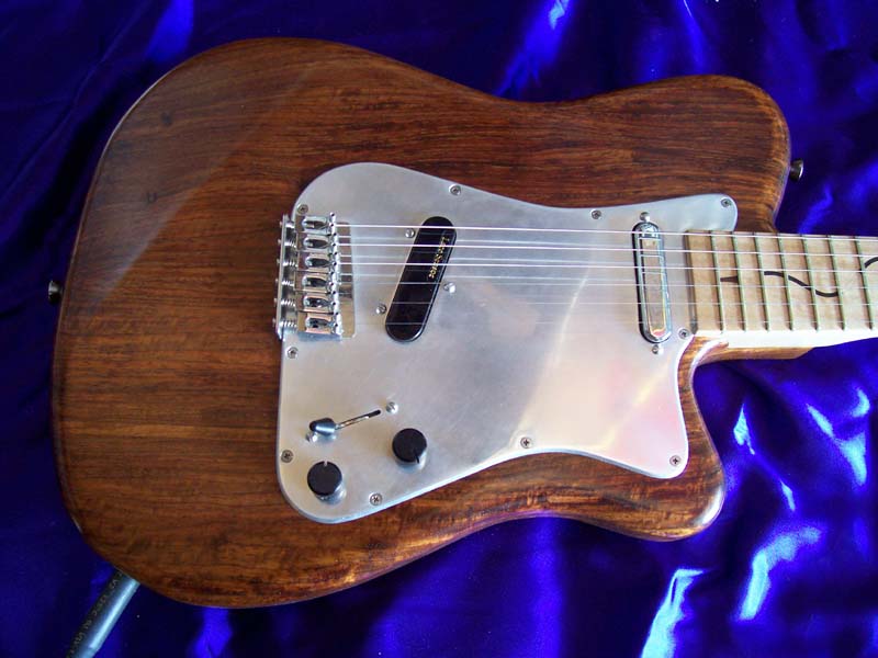

I thought this might go ok after reading through the thesis you posted Dave.
I've had this almost finished for a while but finally put the neck on and strung it up today.
PNG rosewood body with tung oil, rock maple neck with polyurethane, cocobolo as well as green abalone inlay, Lace hot tele pickups and aluminium pickguard.
The sadles sit directly on the pickguard so i had to inlay a piece of 1mm stainless flush into the 2mm aluminium or the adjusters would have just gouged it out.
I'm not sure if it will be everyones cup of tea but I love aluminim next to wood and also the way you can work aluminium with a router as you
do with wood.

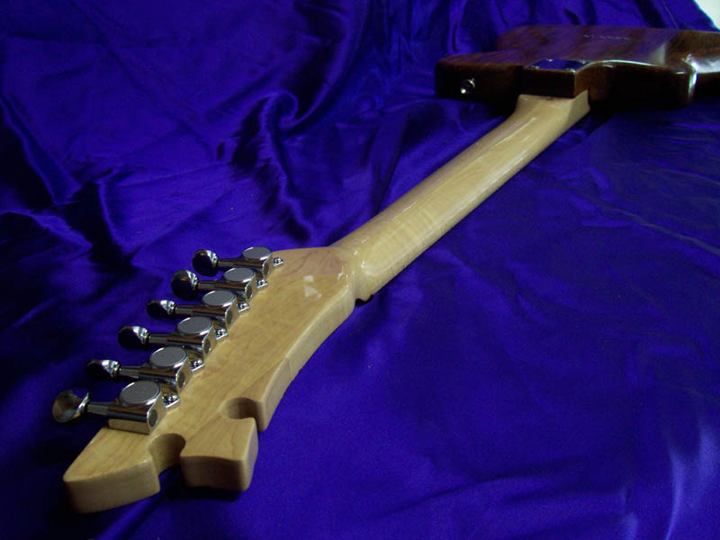

I am happy with the polyurethane on the neck, it was a bit of a experiment though and doubt I'll use it again.

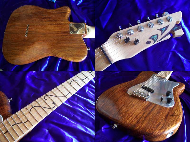

Notice the Stewy Mac output jack plate, it goes well with the pickguard. I don't like the look of the string Ts but I like the function. The neck inlay marks the trad frets as well as being a bit of bling.

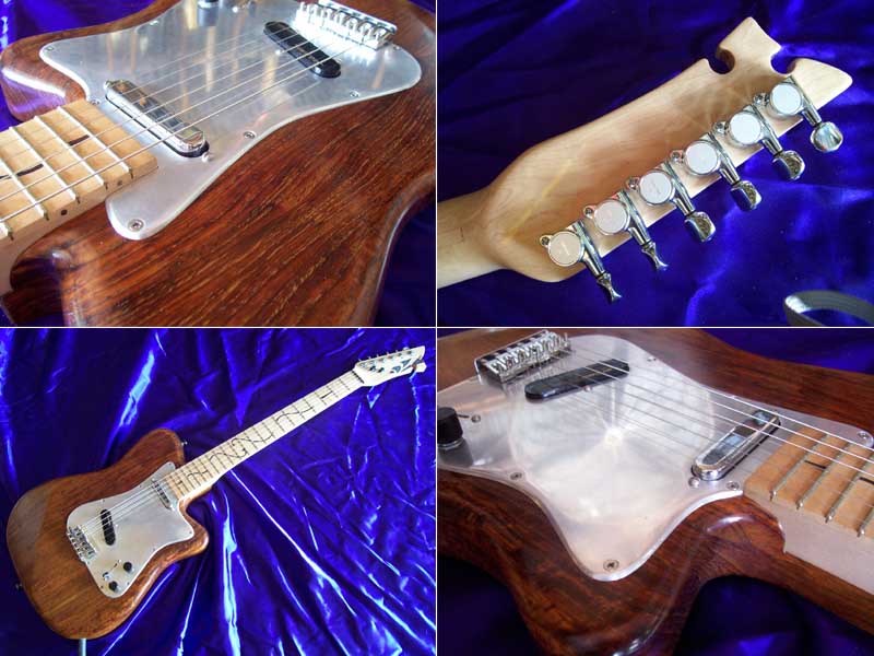

There are many unique design elements you can be proud of Jim. Beautiful work!
I love the "jigsaw" headstock.

How do you like the Tung Oil as a finish for the body?

Nice feel to that one Jim. I like the headstock too and the fingerboard inlay is "trés elegant".
What's the nut material?

"Graph Tech", Bob. Some sort of extra slippery graphite with "microscopic lubricants" :shock: I can't see it though.
I'm happy with the tung oil Allen. I have used it on coffee tables for years but it's only good if you want that old wood patina look rather than a glossy look.

"jigsaw" I hadn't thought of that but now you've got me thinking about my next electric Pete.

That is really beautiful work and unique, tasteful styling. You have got me thinking about making an electric, which is something I haven't been interested in before. How do you work with the sheet aluminium - what sort of cutting tools are best, and how do you finish it?

Glad to have given you a bit of a push Mark. I just use a router, carbide tiped router bits and templates to cut the aluminium then fine wet and dry and a buffing wheel to polish.

Cheers all again, especially about the headstock, I find designing headstocks a huge challenge. The next one is a bit straight but I have something a little different for the one after that.
