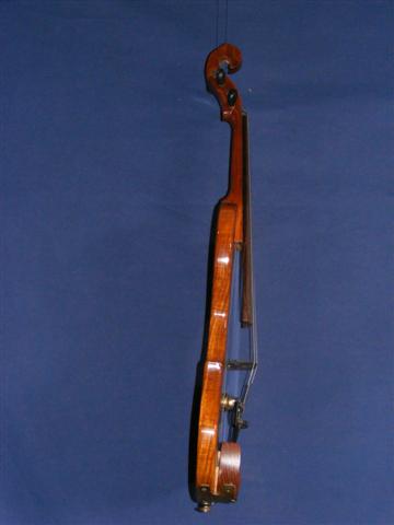

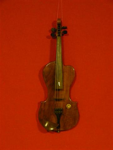

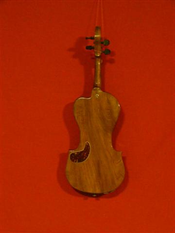

It might be a while till I post my most recent built guitars as
guitar building has come to a standstill as far as gluing goes, and thats where I'm at this time. So I thought you may be interested in this solid body electric violin I built some time ago.
The body and neck are Osage Orange [Maclura pomifera] I believe it's also called Indian Bow Wood.
The fingerboard is ebony. It has a bolt on neck and MOP inlay. The finish is nitro.

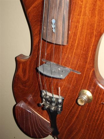

Thanks for comments................Pickup piezo Martin undersaddle inlaid under the feet of the bridge. Sounds not close to acoustic but can be pleasant depending on the EQ effects used. Plays well I'm told.
Post by Allen » Thu Feb 05, 2009 6:39 pm
So the piezio just has contact from the outer portions of the bridge, or is the bridge on this one not quite the same as one on a conventional violin?

Hi Allen, I layed the pickup in a routed slot with an ebony shim on top the regular fiddle bridge stands on top, feet are reshaped of course, photo may help.

Post by Allen » Fri Feb 06, 2009 6:14 pm
Thanks for the picture Taffy. It all makes sense now. I'm guessing Matthew doesn't want to haul around a solid body Bass though. :lol:

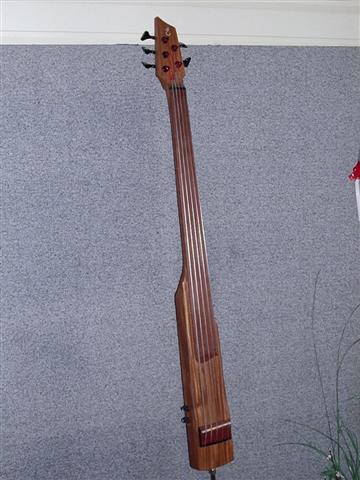

Like this one Allen? very portable and very solid:
Another build from the more recent past.
Post by Allen » Sat Feb 07, 2009 4:50 pm
Now there's an instrument that I'd like to be holding when a bar fight breaks out. 8)
