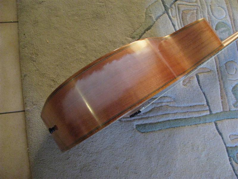

Post by Bob Connor » Sun Jan 25, 2009 8:46 pm
I brought this guitar back from Tasmania with me.
It's finished with Hard Shellac (version 1) which shows no signs of crazing.
It was delivered in September 2007 so I guess the finish was applied in July of that year.
The owner noticed the discolouration after he started playing it standing up and using a strap (in the last couple of months).
So the affected area is in close proximity to his right armpit.
I jokingly asked him if he'd been drinking a lot of Vodka, but I think it's a combination of perspiration and/or deodorant. Maybe the shellac doesn't like aluminium chlorohydrate.
Anyone got any other theories?
Whichever, it's going to get re-finished with pre-cat laquer.

Well, if the crazing problem has been solved in the new version with the addition of a plasticiser, I doubt it'll affect the product's propensity to discolour as Bob's photos clearly show.
As luck would have it, I finished spraying the first of the four guitars I have ready for finishing with hard shellac a few days ago. It certainly went on well enough and looks good (despite my dodgy spraying technique and the fact that it hasn't yet been rubbed out) , but Bob's photos pretty much seal it's fate as far as it's future use goes. Fortunately, the guitar I've sprayed is for my personal use.
It's a real shame, but with hopes of selling to customers in the near future, I think that's the end of the story for me; the other finishing options have just moved up the list a notch.

It does look like your average moisture damaged shellac Bob, the way it isn't so bad close to the back and soundboard where clothes keep it a little dryer.
Your thoughts on the deodorant are not to be dismissed though, is there any chance you could get some of the deodorant the owner is using and try that before you re-spray. It would be nice to confirm if it is just sweat and not the deodorant.

Good idea about the deodorant Jim. I'll give him a buzz and see what it was.
It certainly does look like typical moisture discolouration but the Hard Shellac is supposed to cross-link after about 20 days and prevent this sort of thing happening. That's why I think there must be something else to it.
The guitar I use every day is finished with Hard shellac and doesn't show any symptoms like this, and this is the first instrument that's done this so maybe this guy has that sweat that kills strings (and guitar finishes)
Bob. if that's the case, you'd expect the neck to be affected the same way. What's it look like?

The neck is fine Pete.

Looks like moisture build to me to Bob, I suggest leaving it in a dryer place than tassie for a few weeks and watching what happens. If it clears, coat with wax and send her back with advice to the owner to do same on a regular basis to keep the moisture out.

Bob my friend I have a guitar (and old Guild) that looks just like that and even though the Guild was finished in nitro I know what caused the finish problem. It was mosquito repellent that I had on when I played the guitar. It ate right into the finish.........
Just a thought.

I'm fairly certain that this problem is person specific as there are quite a few of our guitars with shellac finishes that are not displaying the same problem.

Looks like the guitar was put away in a damp place for a while, to me.
how could sweat leave a pattern like that, without touching the edges?
maybe he put the guitar back in its case with the damp strap still attached?
wouldn't a rub with the ol' french polish reviver fix it?
