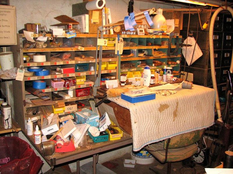

5. Hardware store changing its display shelving? I picked up two of these for $5 each and now have dozens of cubby holes for parts storage right in front of my immaculate small work area.
http://www.ukuleles.comImage
