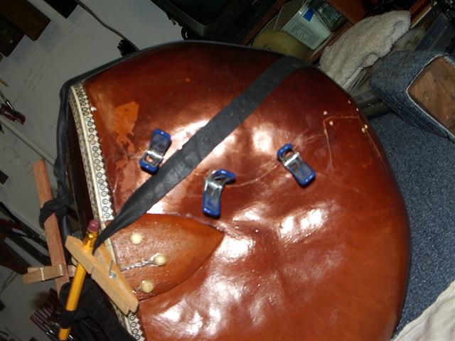

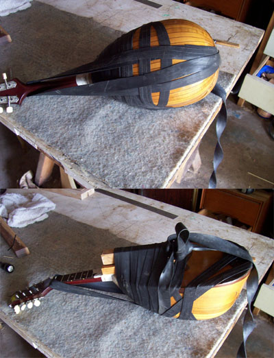

I thought I might try to beat you to this one Taffy as I would gamble that you have a bit of this hanging around your shed somewhere.

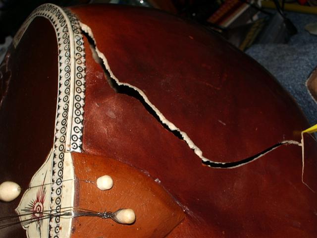

This would be my favorite and perhaps most used piece of recycled material that I posses. Old truck tyres are handy for many things, I use them for the tyres on my band saw as well as anything that needs a bit of firm cushioning. Best to source them in the dry season up here though so you don't have to compete with the kids that want them to use in the swollen creeks this time of year.
They work very well when you need to clamp difficult shapes. This is a recent neck repair job on a shell back mandolin.

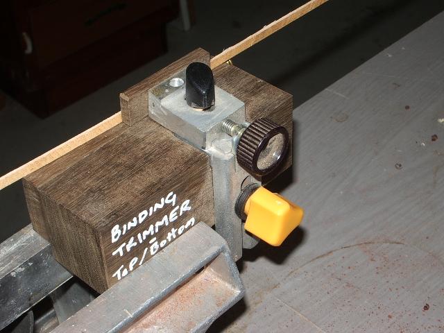

I hope this is the one......

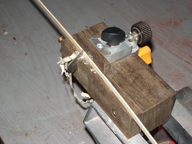

G’day Lillian, here’s a bit more on the binding thicknesser you asked about.

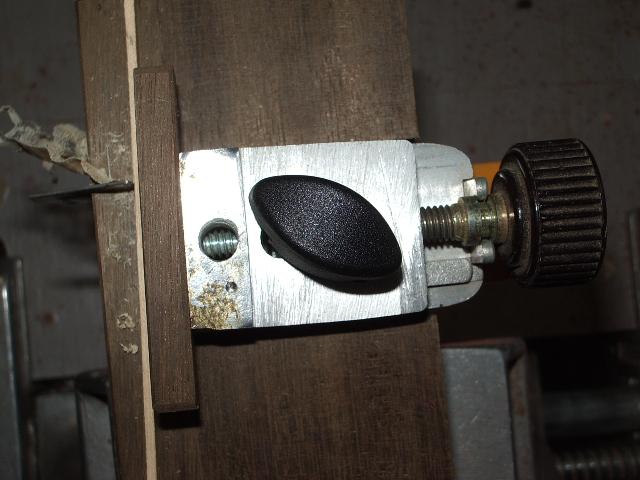

The fittings are from a Makita trimmer, the yellow knob holds the fitting to the main wood body
The knob above that is the fine adjustment of cut
The knob above that is the locking screw that locks the fence in place

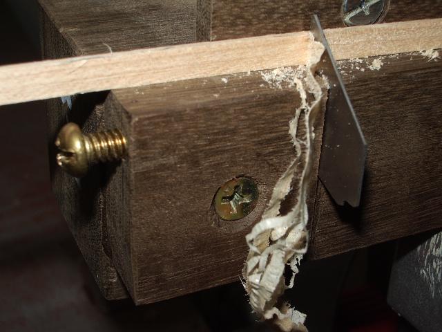

The brass screw is threaded into the timber body and makes contact with the blade and locks it in place, a box cutter or Stanley knife blade in this case.
It could be made much simpler with the fence being locked down by two wing nuts [a piece of hardwood with two slots in it to allow adjustment]. As one needs to take fine cuts [as I get chatter, but this could be alleviated by mounting the blade more firmly I suspect] the micro adjustment makes it more user friendly anyway.
I made it for use with some plastic binding that I had to use on a couple of guitars, I don’t use plastic unless I really have to, but with some repairs I do.
