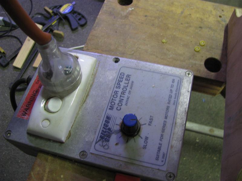

Dave/Allen,
I found an old reference in another forum to a 220V router speed controller sold by Timbecon, a woodworking supplier here in Perth, but it's no longer advertised on their web site.
I scoured the internet last night but can't find another source for one here in Oz. They are certainly a cheap option, but all those I found are from overseas sellers and are 110V.

Heres something from Jaycar but its only rated to 600W continuous, 1200W maximum.

I emailed Powerform Controls in Sydney about their range of motor speed controls and received this reply:
Have a look at their web site at http://www.powerform.com.au
The unit they recommend - the MSR2000 - is $99 + $16 freight.We have supplied other instrument builders with similar requirements. Either our MSL1200 or MSR2000 would be suitable. I would suggest the MSR 2000 so you have a good overload leeway. You may need this because your heater is rated at 1065W 220 V. At 240 V it will be drawing ~1170 W which is right on the max for the MSL1200. If you want continuous user adjustable power then the units to consider would be the MSC1200 and MSR2000+RC10. Both can be supplied as panel mount or on a wall plate with switch.

As I traded in the angry woman for a more sedate model, and dinner time happens if and when we're hungry, I'll opt for the MSR2000 and set a predetermined upper limit of 300F or thereabouts. The additional RC10 control they mention allows you to more easily tweak the temperature threshold on the fly apparently, but I doubt that'll be necessary once I've dialled in a temperature that's working for me.
