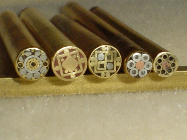

Nick, I've seen silver and copper wire as well as brass rod used. You can even use tubing and fill it with rods. Knife makers use this technique for custom rivets. Epoxy fills in the spaces.

Even just straight epoxy. You can colour it with all sorts of things even make two tone swirly stuff or faux marble.

This is what I was talking about.
