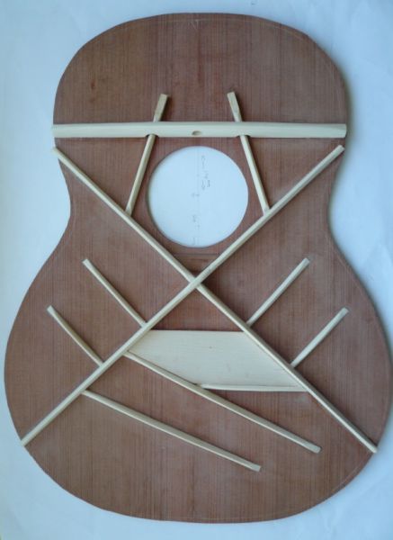

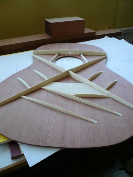

Lillian, I do put a rough longitudinal shape on the top of the 'parabolic' braces before I glue them to the top. As you can see here they are not all the same profile.
The peaks of the 'parabola' are in different places according to the position of the brace. The upper tone and finger bars have the peak approximately one third of the distance from the X brace and the lower tone and finger the peak is halfway from the X.
I've found this to be an almost constant after about 25 or so tops using this system. All of my braces are inlet into the X as I'm trying to build a single bracing network on the top rather than discrete separate braces.
