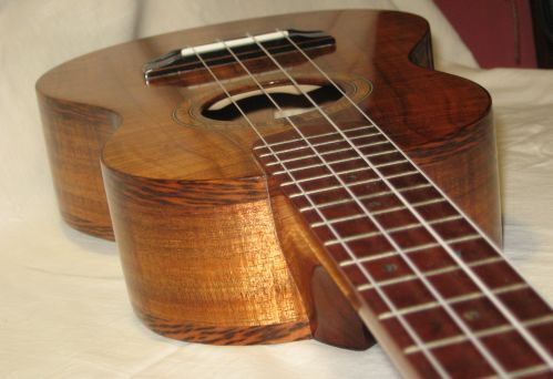

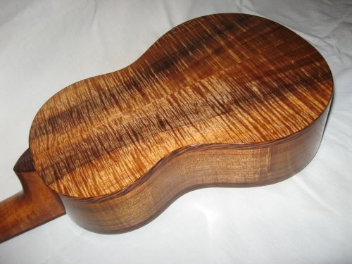

I have used the new formula Ubeaut Hard shellac on both my weissenborn copy guitars. The finish has been on since october last year and shows no signs of degredation. Each guitar received a few wash coats of the new formula hard shellac, then six 2 pound cut and then two straight from the bottle. I applied with a rubber lightly sanding between each coat. After the last two coats the guitars where left to dry and cross link for a month before sanding down to 600 grit and then polishing. I used renaissence wax and hand polished out the final finish.
I think the finish is nice and hard and it looks good. It is only satin and it was my first go at a serious finish. I did carfully prepare making sure the guitars where completely dry between each coat. I do reckon that the humidity levels have to be right when applying the hard shellac. Here in North Queensland I have to choose my days carefully.
I am very much a beginner builder and by no means an expert on the subject. This is just my opinion and what I found using the product.
Here are two pics of the Ubeat.

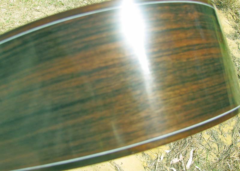

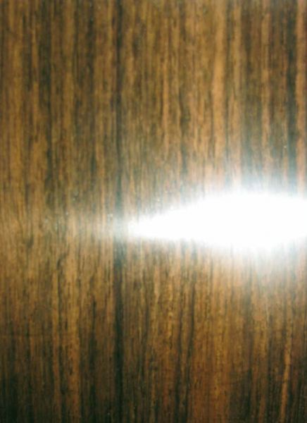

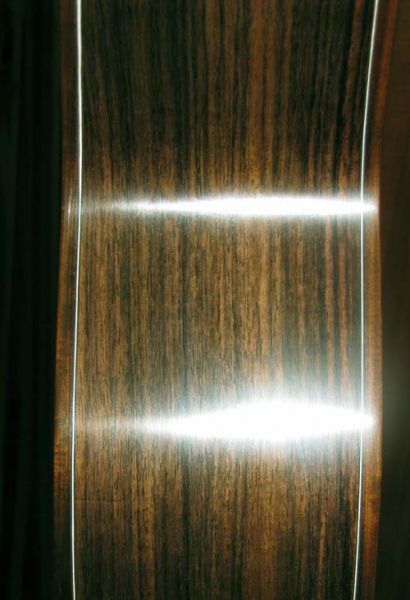

As a few of you know I had a disagreement with Zpoxy and the Zpoxy won. I developed a rather nasty sensitivity to epoxy just as I was about finished grain filling some EIR. The problem for me was that I needed to sand off the last filler coat I had applied just before I became ill and then apply a final wash coat if I was to avoid patchiness.
Well if you seen the images of my arm in my epoxy warning thread, you will fully understand why that was never going to happen
. So this left me with a bit of a problem. When I sanded back the Zpoxy and leveled things out, as you would expect there were a few patches where some remained. Sanding it all out completely would have meant sanding out the filler in other areas and starting the whole grain filling process again form scratch.
I am all set up to spray nitro now, got the compressor, got the gun, got the pre-cat and water trap etc, etc, but nitro would have really highlighted those remaining patches of Zpoxy. So what to do?? I read somewhere that True-Oil is a good way to over come this problem so I decided to give it a go.
I must say that so far, this stuff looks very promising. I sanded back to 240 and wiped on a thinned down wash coat of white dewaxed shellac. I very lightly sanded this out from 240 thru 600 and applied a thin coat of True-Oil without wiping off the excess and left this sit overnight.
This morning I sanded out 240 thru 800 and reapplied True-Oil wiping off any excess to leave only an ultru thin coat. This arvo I very lightly rubbed back the surface with 0000 steelwool and blew everything clear with air. I then reapplied True-Oil and rubbed off the excess. It was stink'in hot when I was doing this, about 45C in my shed so the oil was drying very quickly. I kept at it with a clean bit of white bed sheet (she'll never know
) and burnished the oil as it continued to dry. I working one area at a time, say 1/2 of a side and then burnish lightly, do the other half the same, back to the first and burnish harder and then blend the two work areas together.
Here it is so far straight off the rag, no polish or buffing, just 3 coats of true oil and a bit of rubbing with a clean rag in between. Sorry about the poor quality images, it really does look much more impressive in real life.
I will do a few more coats tomorrow but so far, so good. I must say that this is pretty impressive stuff to use and dead easy too. I would think that a few more coats, let it harden up for a couple of weeks, micromesh from 6000 to 12000 and then some McGuire's, and this will be an ultra thin, acoustically transparent finish with great depth and a very acceptable gloss level that is easy to repair. An if that is the case, I would not hesitate to buy a guitar coated with True-Oil.

Thanks for that post, Kim ... you've restored my faith in being a convert to Tru-Oil. I am reckoning that if it's good enough for preserving gun stocks that get a fair bit of rough treatment, why not apply it to instruments!!
Have only had one go at using it, on a Tenor Uke of high-figured Tassie Blackwood w/Tiger Myrtle bindings from TimS. This finishing process was very much trial & error, with several helpful hints from Dave Hurd, and I made sure to try the technique out on a sample board first to build confidence.
I sanded the surface to 600grit after pore filling with some watery pre-coloured timber putty from Bunnings. Six coats of Tru-Oil was applied (importantly, with 'smooth' rag e.g. T-Shirt material that needs to be clean and LINT FREE), each coat a day apart and rubbed with 0000 steel wool between coats. I didn't try to burnish each coat as you've suggested Kim, just applied it evenly and stopped rubbing after a few minutes when the oil became tacky. Because it was on a uke I did a whole surface in one go but on a larger bodied instrument your idea of doing a panel in stages is a good one.
After 6 coats I let the uke sit for 5 weeks to harden off, then did a light rubbing with wet 4000 Micromesh, then treated it with a coat of 02B ultra-fine cutting compound all over.
To finish the process I did a coat or two of Feats-Watson Carnauba Wax (brown) and rubbed like hell to a fairly fine gloss.
View down the neck, OrganOil applied to fingerboard, and yeah - the bindings ARE too fat - the routing bit in the Dremel slipped - but that's a whole other story:
View of back:
I still have reservations about the carcenogenicity of this product but like any modern-day chemical I think it's important to observe good OH&S practices i.e. use kitchen gloves and/or wash hands after use, and dispose of rags appropriately (let 'em dry first!). One other thing I did was not to re-use the rag from previous coat - throw it way and get a new bit. Also, KEEP THE LID ON the bottle, this stuff develops a skin when in contact with air. In fact David Hurd made a good suggestion to me to just prick the foil seal with a panel pin when opening for the first time, and apply the oil as drops.
