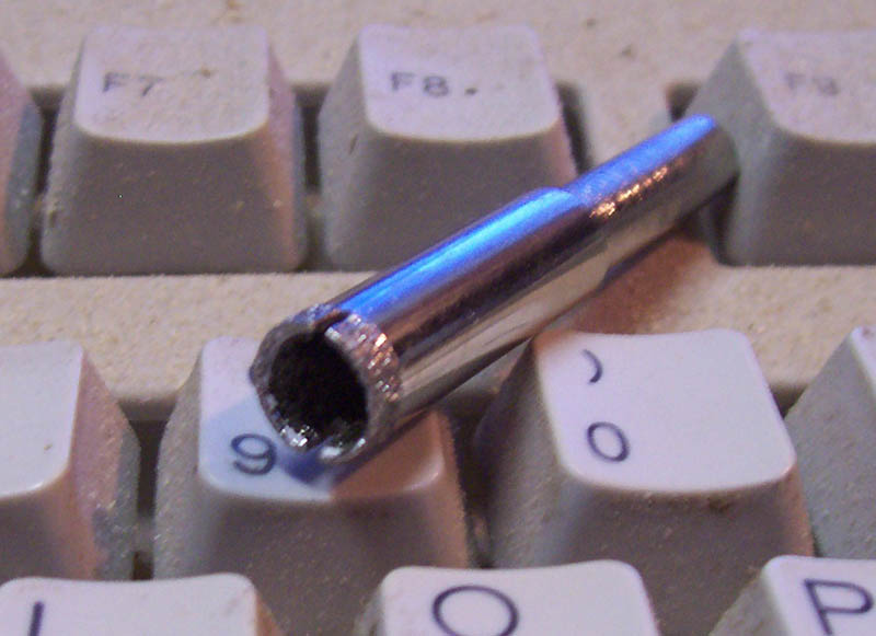

One of the best ways to drill Mop I have found is to buy those diamond drill bits from Lapidary supply places. You can cut any size hole in one go without fear of breaking the Mop as they are abrasive rather than cutting edge tools. They are made for cutting stone and Mop is much softer.
They call them drill bits but they are more like hole saws as you not only cut a hole but you get left with a plug. I use them for cutting "dots" out of Mop rather than buying them when I have little offcuts anyway. One downside is that they don't have a center point so they need to be used in a drill press with the work piece held firmly. On the up though they are only a few bucks each.
My smallest one cuts around a 2mm dot. The one in the pic cuts a 6mm dot.

Cool tool Jim, I have not come across them before but they look good. Where did you buy your from if you don't mind me asking.
Post by DarwinStrings » Thu Jan 08, 2009 8:45 pm
Don't mind at all Kim, I should have just put it in my reply anyway.
It was a company called Gemcuts Lapiday Supplies who are in Qld and NSW but you may find someone closer. Here is the URL.
http://www.gemcuts.com.au/index.htm
Post by Allen » Sun Jan 11, 2009 6:16 pm
Hey Jim, on their web site, does the size of the bit refer to the size of the hole, or the size of the plug that it's going to cut. I'm going to order a selection of them, but don't want to stuff up on the sizes by too much.
Post by DarwinStrings » Sun Jan 11, 2009 7:41 pm
Size of the hole they drill Allen. their plug cutting ability is coincidental.
