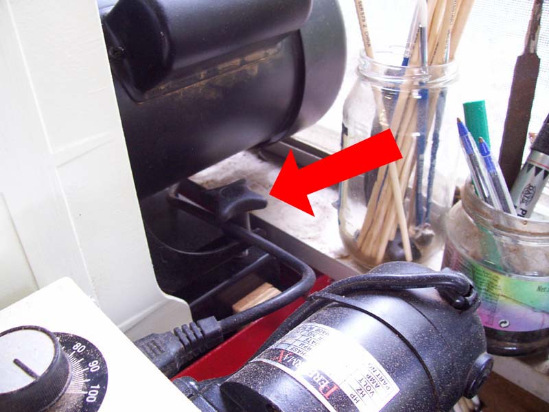

Unless yours is a different model to my Performax 16/32 yours should have a adjustment as mine does ( see pic ). To adjust it I losened the bolts that hold the sander frame to the base plate not all four but just the two that are closest to the drum or feed belt. I then wound the adjuster down till I could tell by eye that the outer edge of the drum was higher, that is the end of the drum furthest away from the motor. I then ran a piece of wood through close to the motor to get a thickness at that side, Then ran it throught the outer edge and wound the adjuster til the drum just touched the piece of wood being fed through. I just kept feeding that piece through on both extremes of the drum and adjusting slightly till they matched. That is to say i could hear the drum just touching the wood as it was being fed through.
The manual does it differently but this method did me.
Good luck and ask again if you can't manage from that description.

That's different than the one I had to adjust Jim. That looks like a heck of a lot easier to work on.

Mine has nothing like what you've shown in the pic. That'd be ideal if I had one. In fact my frame looks completely different from yours. I think mine might be an earlier model.
